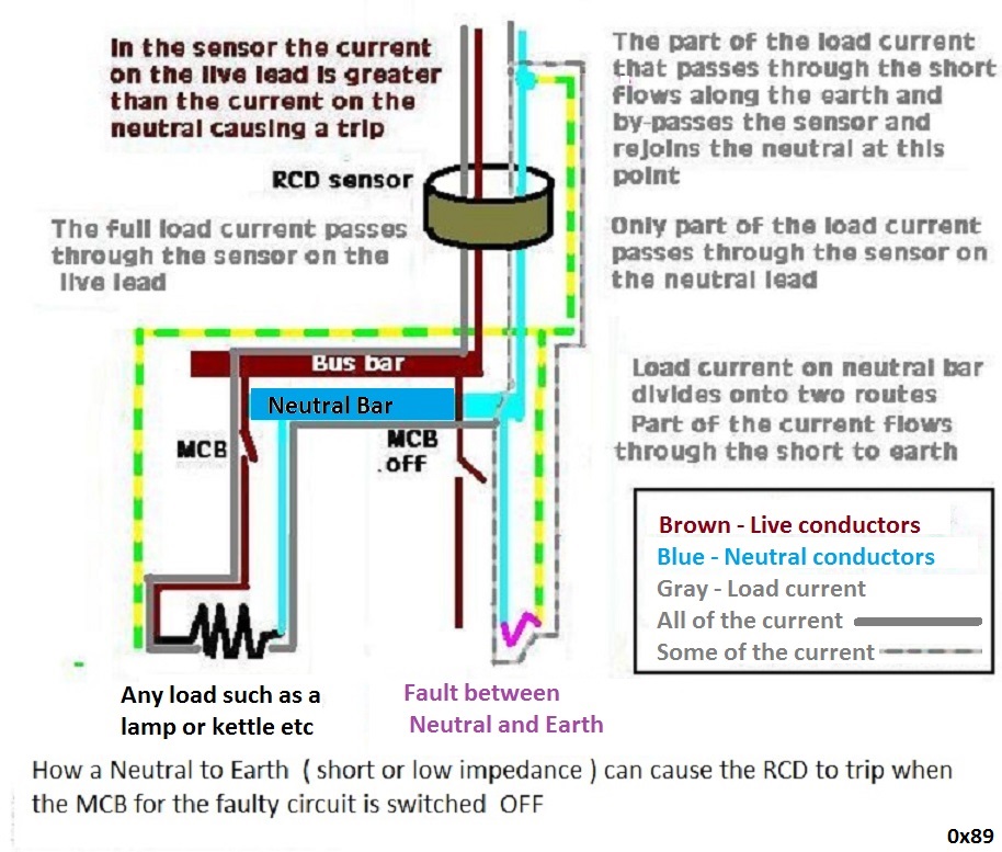

Been reading some bits and bobs on RCD nuisance trips.
Can someone explain to me which type of testing is for what and why you would do one over the other or both
1. An earth clamp meter..... turn all circuits off at CU, clamp main earth at CU, take readings for each circuit in turn, points you in right direction of which circuit to investigate further.
2. Insulation resistance test...... turn all circuits off, test insulation resistance at 500v for each, points you in right direction of which circuit.
Am I missing something? Why would you do both or why would you choose one over the other?

Clamping on the Earth conductor or CPC may show no current if the fault is to Earth and not the CPC
Measuring the Insulation Resistance is essential in determining where the fault is as the fault can still cause the RCD to trip even if the MCB for the faulty circuit is switched OFF
I think it is just that Earth Leakage clamp meters are relatively recent.
IR testing is rather laborious - having to disconnect wires.
With the clamp meter on the main tails you get a live readout of what is happening, by switching on and off various appliances and circuits, and can deduce what is happening overall - although, not necessarily where; see Bernard's diagram.
