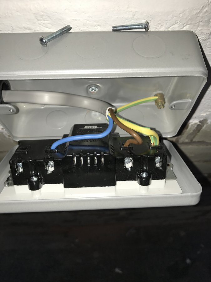

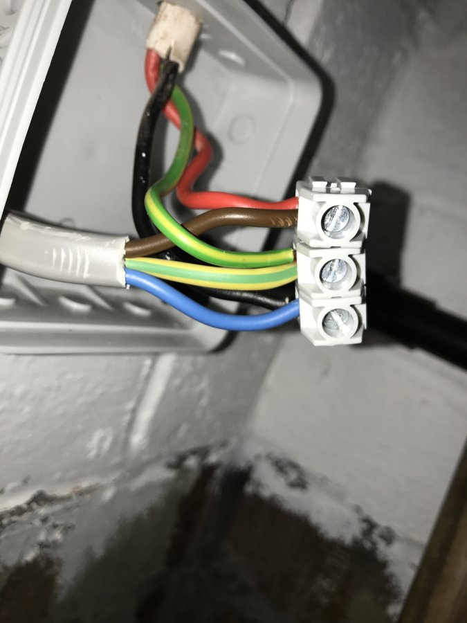

Removed a double socket in the garage, extended the cable via a junction box and connected up an RCD two gang metal clad socket. Turned the power on, made live the socket and it trip the main RCD protected switch on the fuse board. Totally confused why this has happened. Is the socket faulty? Have I somehow wired it wrong? Are the electrics in the garage shot?

So cable is run from a spur from the house to the garage. Goes into a consumer unit in garage and then to the sockets. The RCD double socket was bought from Toolstation. Pictures of junction box and socket wiring.

I don't see anything wrong with the wiring in your photos, and I don't think your main RCD should trip in that case. You should investigate and find out why it does.
I'd start by disconnecting the RCD socket; that will confirm if the problem is in the new cable or junction box (nail through the wire?)
If that is OK, I'd try reconnecting the wires to the RCD socket one at a time (E then N then L) and checking what happens each time.
