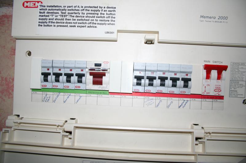

Anyone have any ideas to what is causing my symptoms? I've included a pic of my CU if that helps at all. If there is any more info you need let me know.

My eyes not being what they used to be... Which of those breakers is controlling the garage?

BS3036: Whoever installed this box did a bad job of labelling the breakers. The garage id connected to the 2nd from the left. It shares this with the upstairs ringmain.

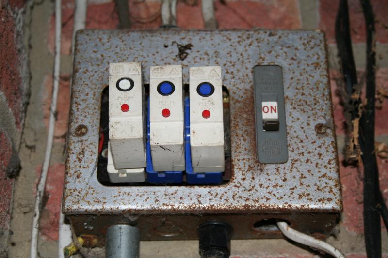

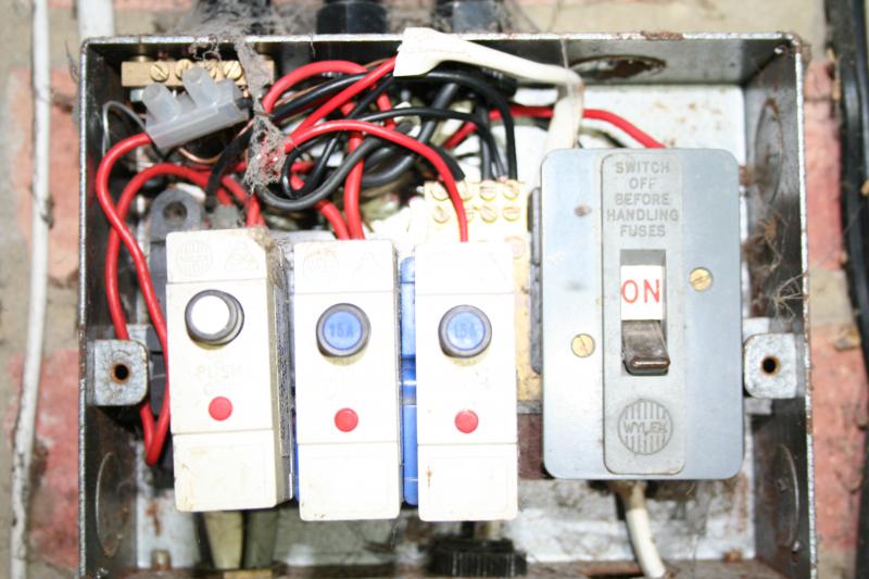

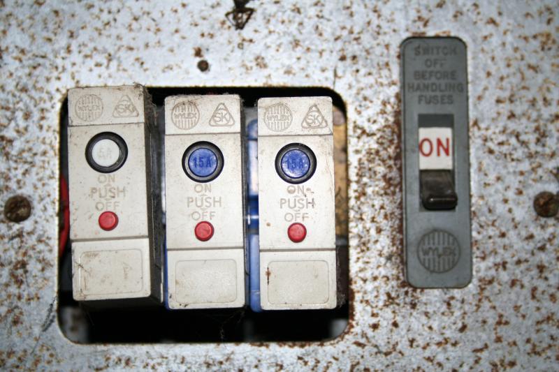

sparkwright: I knew I forgot to mention something. There is an old box in the garage with 3 breakers in it. 1 x 5A and 2x 15A. The lighting is attached to the 5A, and the sockets are attached to the first of the 15A. The 2nd 15A breaker is now unused. It did have several transformers attached to it to power outdoor lights (via a 4-way switch), but as none of them work any longer I completely removed those connections from the box. I did take a picture but it didn't come out too clearly. I can try and get one again later if it helps.

Today, as well as disconnecting everything that was unneeded, and testing without the outdoor lights attached I did another test. I attached the Dryer to a socket in the kitchen (on a different MCB protected by the same RCD) with an extension lead and when I switched off the garage light, the RCD tripped again.
I'm beginning to think that the problem lies with the Dryer itself, but I'm reluctant to go out and get a new one only to find I get the same problem. When I get a chance I will take a look inside the dryer to see if there is any sign of water inside the unit. It wouldn't surprise me to find condensation accumulating as it is pretty cold in the garage at this time of year.
I've been thinking along the lines that the garage neutral is connected to the neutral bar on the 'not protected by rcd' side. A photo inside the cu may help, but I don't want to encourage you to provide one if you're not going to do it safely. It would definately involve switching the main switch on the cu first.

Do you mean the main CU in the house? Or the one in the garage. If the latter see below as I managed to get some better pics. You can't see all that much of the inside shot, but I had a good poke around and everything looks well connected.
