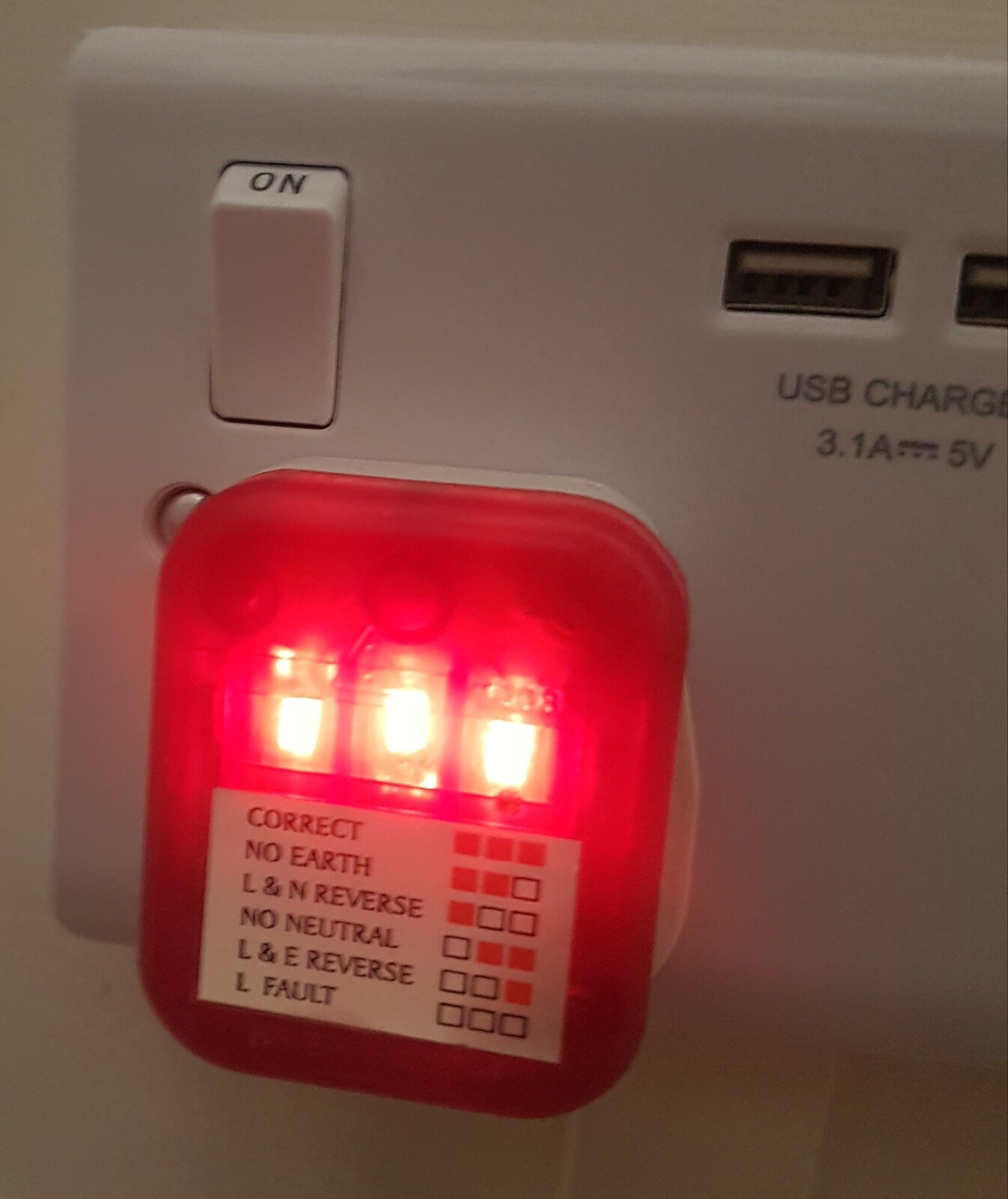

Checked a couple of sockets with a tester, will check them all. I have a multimeter too if that's any help.

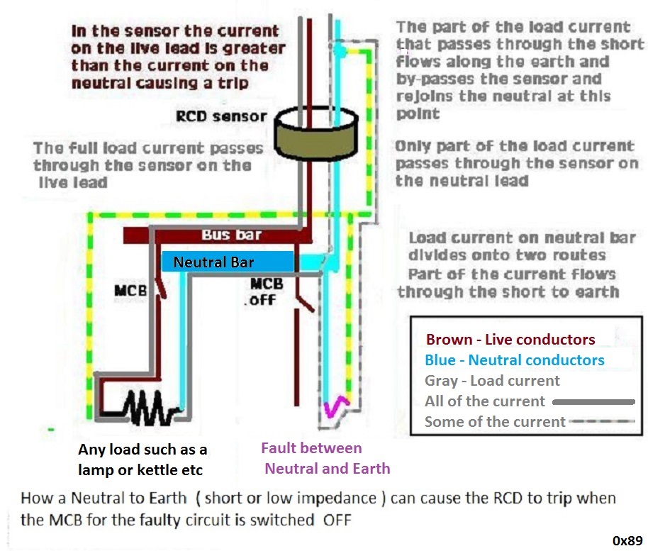

It sounds like a neutral earth fault. With this fault the actually fault can be in the toaster but it seems caused by kettle. So unplug things rather than turn them off, as often switched only turn off the line, so it could all be caused by some thing plugged in but not in use.
Thanks, I'll try that now. Seems to be tripping at random now, just the RCD, even with low powered stuff. I'll go unplug everything then test it.
The Neutral to Earth fault could be anywhere in or around the house, often it is outside lights that have got damp inside the units. The RCD can trip even if the MCB for the faulty circuit has been turned OFF as the MCB does not disconnect the Neutral
