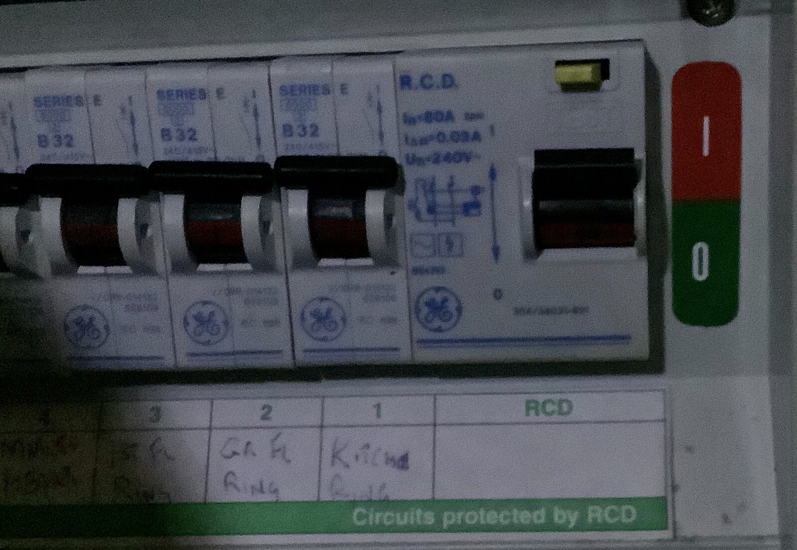

Domestic electrics installed with RCD in 2000, hasn’t been tested or recalibrated since then. Intermittently (but now every time) it trips out when I use the electric oven/grill on my cooker. Curiously though it doesn’t trip out until the oven has heated up. Is this an issue with the cooker or with the RCD?
It's the grill (or oven) at fault, not the RCD. Probably the element shorting to ground when it gets hot would be my guess. Most likely an element replacement will fix it.
Another possible fault is the thermostat creating a short circuit Live to Earth when it switches OFF the supply to the element.
If the un-used OFF contact in the thermostat has developed a conductive path to Earth then when the thermostat switches this path will create a Live to Earth fault.
As has been said the most common cause of that problem is a faulty element but can you post a pic of the rear of the machine that shows the cable entry & suppressor. I had an intermittent fault of the RCD being tripped caused by an oven that only showed when hot & it was the leg of a component on the suppressor board poking through the back of the board & shorting to the frame of the machine which distorted when oven heated up.
Is there is not an OFF contact? Surely just an ON contact no longer connected.
The thermostat removes supply to the element by forcing a moving contact to move away from the fixed contact that connects to the element.
The moving contact when not touching the fixed contact rests against a back stop. The back stop maybe a second fixed contact ( as in a change-over switch ) or an insulated surface. When the back stop has a path to Earth the RCD will trip when the moving contact touches it.
As others have said.... almost certainly a bad element.
