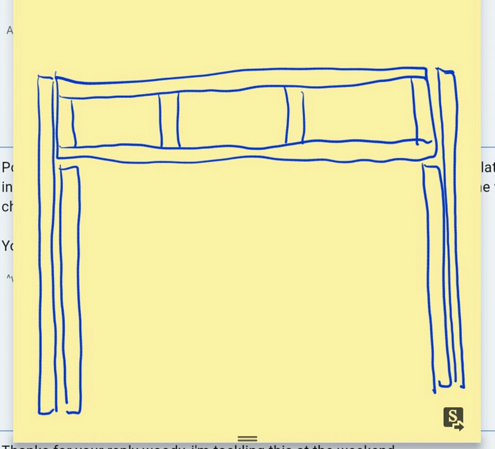

Hi All
We have an old single story single skin block built extension to the rear of the house. It's generally fine but i'd like to improve the appearance and insulation a little and just for my peace of mind, re-enforce it.
It's currently rendered to the outside. I've pulled off the internal plasterboard and there was 25mm polystyrene insulation underneath. It's like a sun room which is open to the house -been there about 30yrs according to a piece of newspaper I found stuffed in the wall. My plan is:
1) Horizontal 25x50mm battening to the outside, insulation, vapour barrier and vertical larch cladding
2) Inside, 50mm square vertical battening, then 50mm insulated plasterboard over it.
I have a few questions:
1) Should I also have a vapour barrier inside?
2) Should I also insulate between the 50mm internal battens?
2) Should this lattice of internal and externals battens and cladding give a good amount of extra strength?
3) Should I Instead leave a 50mm cavity and build an internal stud wall out of 2x4, and insulate the cavity and/or between studs? This is the way I started off thinking but the cavity means the stud wall doesn't offer any actual strength to the existing wall.
Or am I going about it the wrong way completely? I want a simple a cheap way to achieve it really - not rebuilding the walls...
I'm in the UK by the way!
Thanks for any help
