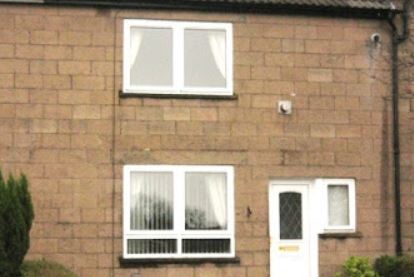

Concrete or thermalite?
Unfortunately I have no idea what type of brick. The house is ex local authority and probably about 40-50 years old if that helps ? Or is there any way to tell ? I've attached a photo of a house that sold on the same street. Thanks
Should take concrete screws .very strong .
