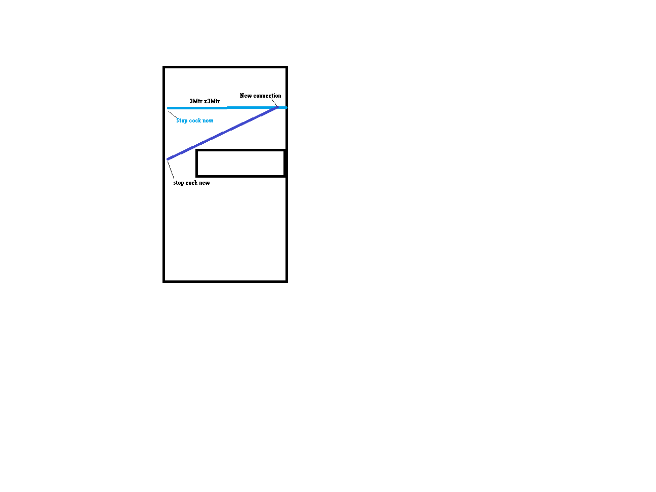

I want to re-locate the stop cock.
The existing input goes under a concrete floor that is going to be dug and insulated.
I want to move the stop cock to the new location in image.
I need a connector from 1inch galvanised steel, to plastic, that needs tro be reliable, as it will be concreted over.
I've done it before on the old stop cock, but are there any recommendations please?
Cheers, Camerart.

There are only really 2 reliable universal adapters for galvy and that would be either Plasson or Philmac.
Hi M,
I haven't found one yet, but the do the ones you know, need the Galvanised pipe to be threaded, or do they clamp on?
EDIT: Found one, thanks.
