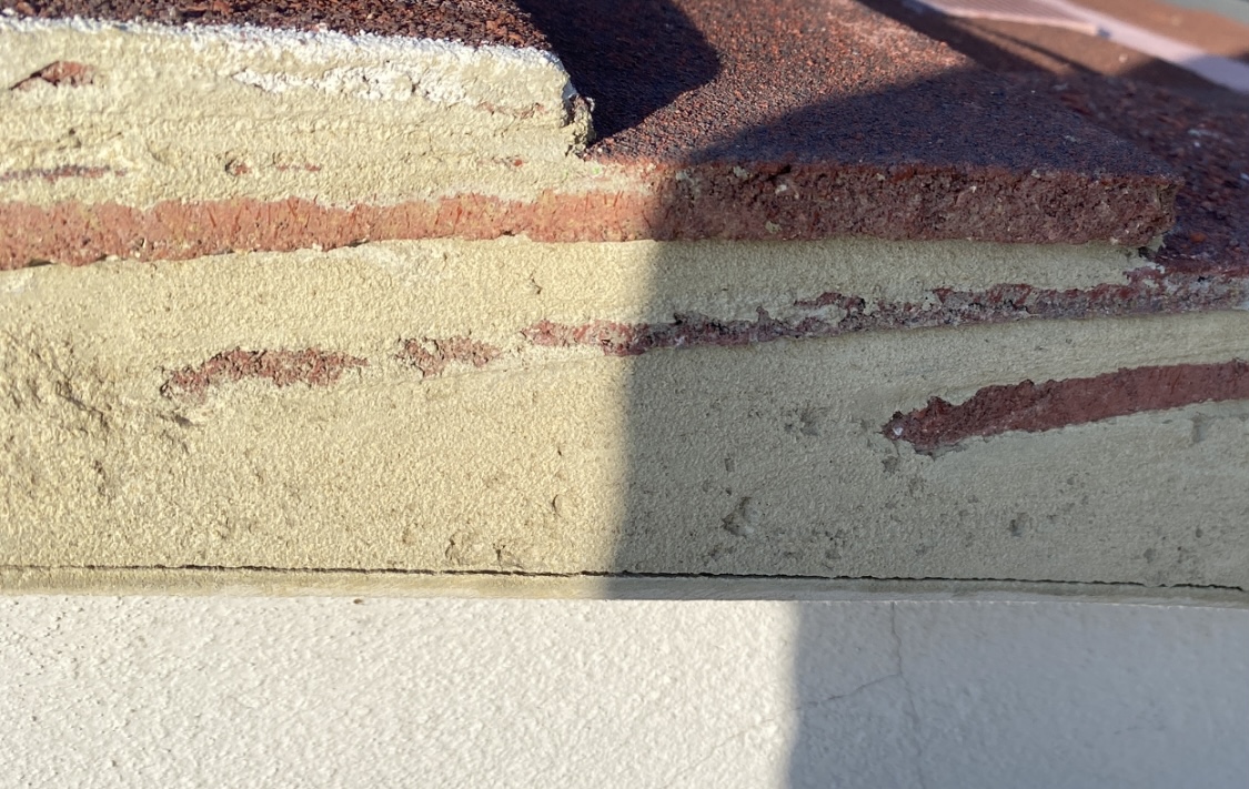

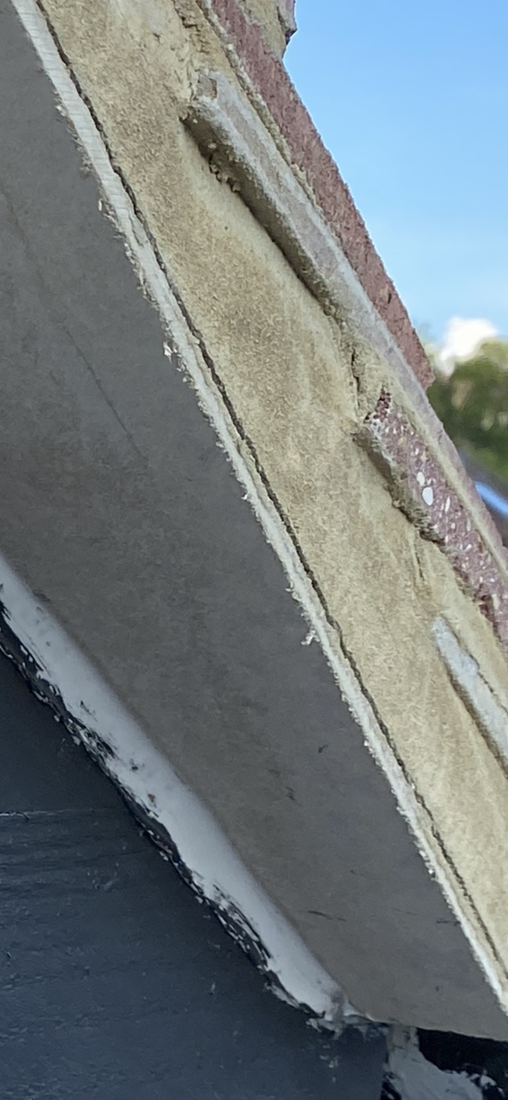

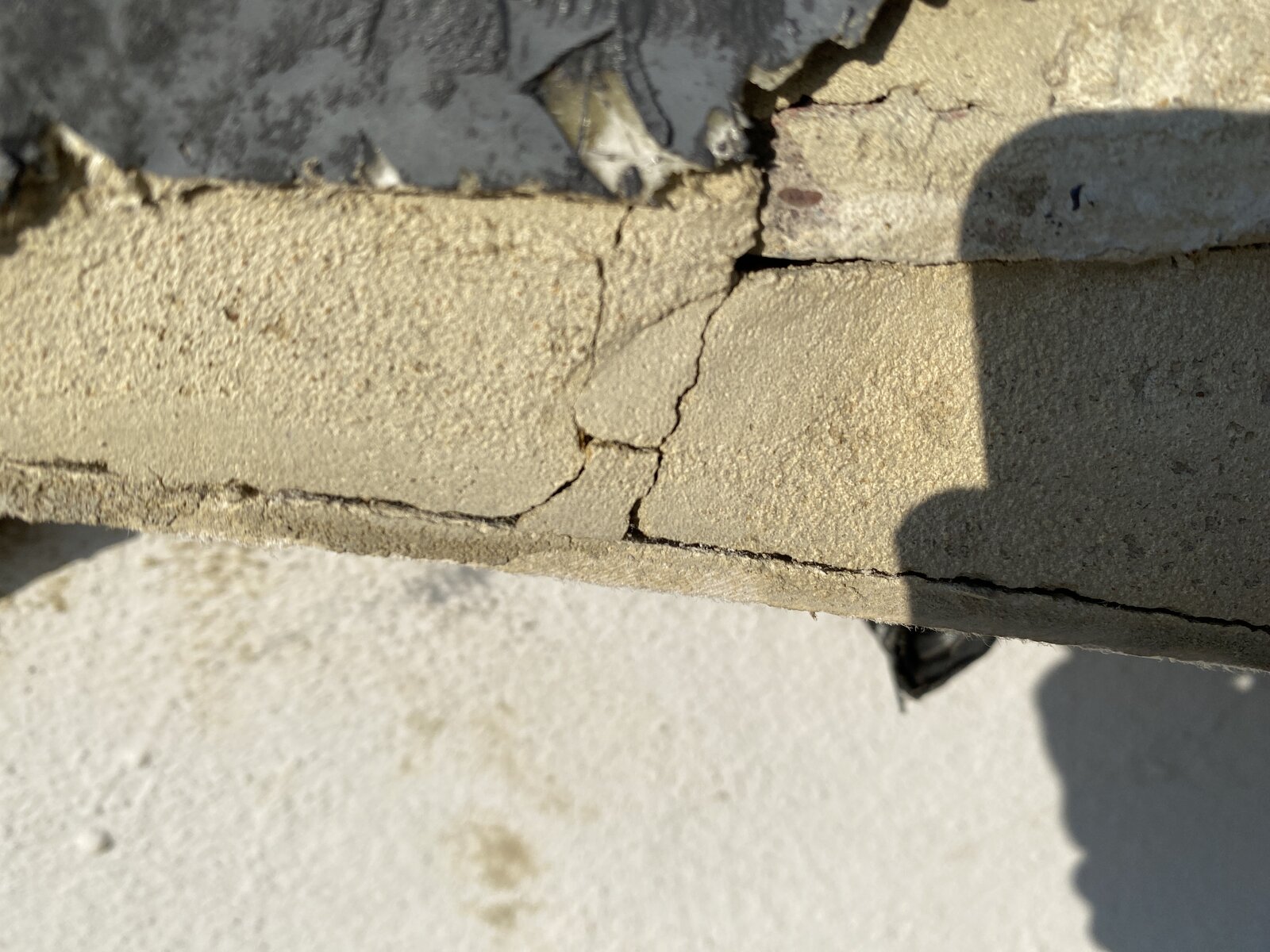

We had our verge mortar replaced one month ago.
The roofer took off all the tiles, replaced the under cloak, and then put new mortar down and replaced the tiles.
Would anyone have any ideas of what went wrong? The mortar has come away from the under cloak along its full length, and a few sections of the mortar are loose - i.e. I can wiggle them with my finger.
Presumably this is unacceptable work?
Is there any easy fix?
Thank you.

Mortar looks quite sandy. Was it done on a hot day, or did it freeze on the night?
I’ve checked the historic weather details, and during the day there was a high of 14 Celsius, and overnight a low of 11 Celsius.
It was a mix of sun and cloud on the day the work was done, and the day after.
Thanks for those replies.
Is there any way to fix this without removing all the mortar and starting again?
Am I right I’m thinking that the mortar should remain firmly bonded to the under cloak for a large number of years?
It has separated along the length of the under cloak.
The roofer says that it was a 3 sand to 1 cement mix.
From a quick search that sounds like the correct ratio?
Would a product like “Soudal Trade Roof & Gutter Sealant 290ml Black” be ok for filling the cracks? (as a DIY quick fix)
And perhaps using some Bostik pre-mixed mortar powder to replace the crumbled parts?
No, either leave it alone or do it again properly. There isn't really a good in between solution.
