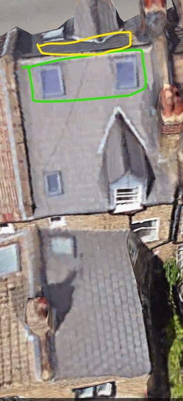

Hello Everyone,
I am looking to get solar panels on my roof, but all installers point out the limitation of space on my top roof, which is really a shame as it is perfectly south facing. I would like to know if anyone could give an estimate of what it would cost to move the two top (green) velux windows over to the north side (yellow area). The loft is fully built out, so one can access them quite easily from the inside for the most part. This would be a major factor in deciding to go ahead with solar panels in the first place, as I am right on the cusp of having space for sufficient panels.
Any advice would be appreciated. See picture below.

Probably, there's a room in the rooof by the looks? As if there is will be quite involved as you would normally double up the rafters either side (assuming they won't fit into the existing spaces between the rafters) so may be quite invasive. Are you prepared to pay for scaffolding or are you expecting a roofer to do it all off a ladder as the old rooflights can only be tiled from above. Really you need three quotes but I'm gonna stick a finger in the air at £2-4k + scaffolding.
How long will it take to pay off the cost of moving the windows with the solar produced? How many more panels will you be able to fit on?

yes the loft is fully built out and plastered, with lights and sockets. Thanks for your guesstimate, I think 2-4k + scaffolding is definitely not worth it.

I've asked 4 companies so far and everybody is coming back with a different configuration (some did not even want to quote). I am already using the entire extension/outrigger roof, but that alone won't be enough. I would require at least 9 panels. I am no expert, but back of the envelope calculations: moving the Velux windows will allow me to add an extra 1 maybe 2 panels. Say 10% more "savings" at best, so maybe 80 quid per year... at 2-4k cost... mhm ok that makes no sense at all.

Most do surveys from google maps. You can input some data in to easy-pv.co.uk to work out how many panels may fit in an area.
Any out buildings? Ground mount array?
Whilst you should fit as many panels as possible - relocating high cost items is not worth while.
Looks like you would lose 2 perhaps 3 panels, you have the added bonus of the roof coming off the main building as well?
You should easily get 6 possibly 7 panels on the main roof then the same on the other part of the roof..
