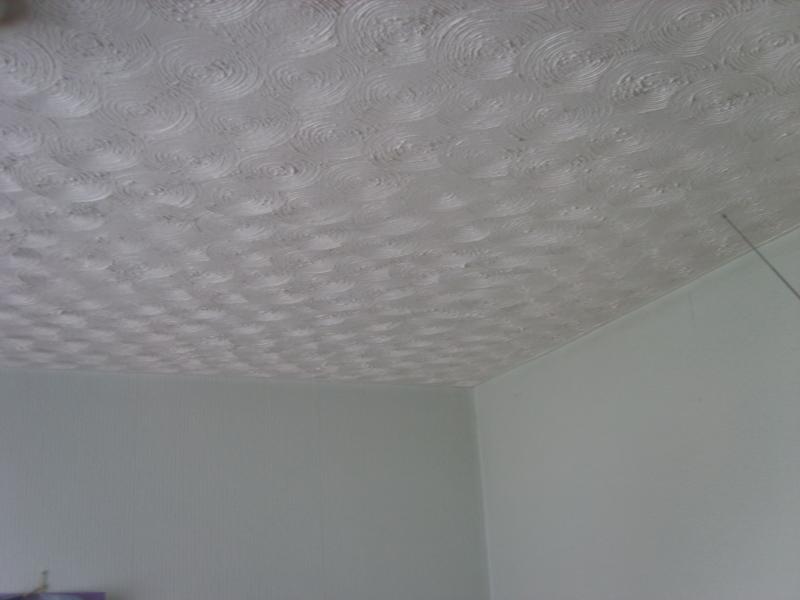

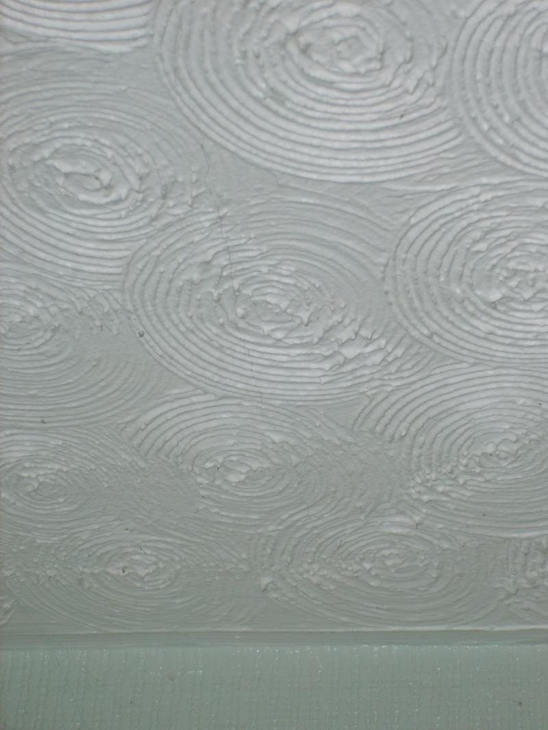

Hi,
I want to skim over two of my artex ceilings. From what I've read, there is a possibility the artex contains asbestos, so I rather be on the safe side. I'm thinking of spraying the ceiling with a water spray and scrape off all the spikes thus possibly avoiding dust. There are loads of spikes, some even over 10mm long! Is that a good way of doing it or is there a better solution?
I'm trying to avoid a wallpaper stripper since I've heard it could blow some areas of the ceiling.

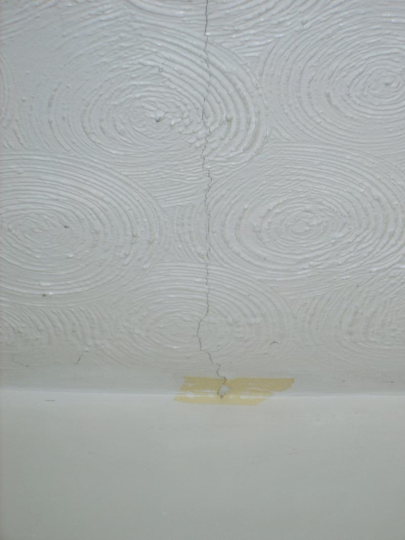

How could I cover the cracks properly if I use plastering tape over such uneven texture?
I have included 3 pics.
Thank you.
Those cracks will still come through a bit of scrim tape cant hold them back
If you are worried about Artex containing asbestos,pehaps you can send a small sample off for testing to be absolutely sure what you are dealing with
The other option is to board over existing ceilings and skim..!! ;) Or tape the cracks with 2 layers of 4" scrim tape set into a tight bonding coat and a tight bonding coat over the ceiling then skim over the lot. Obviously you must have the usual "Prep" work done before the Bonding coat..
