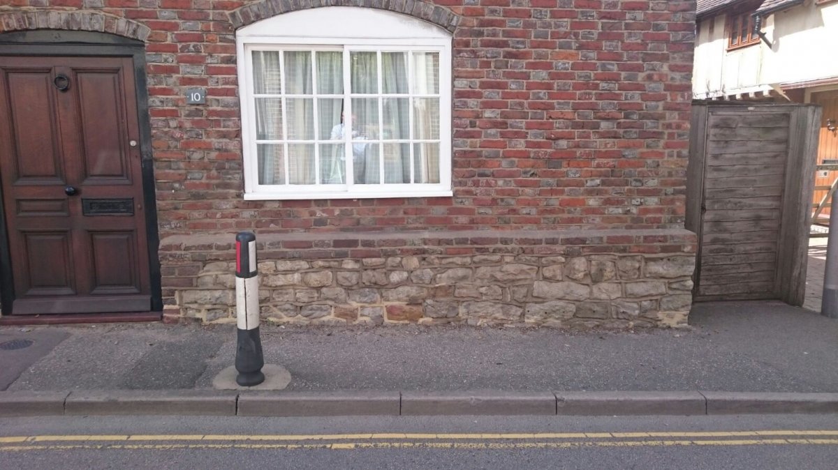

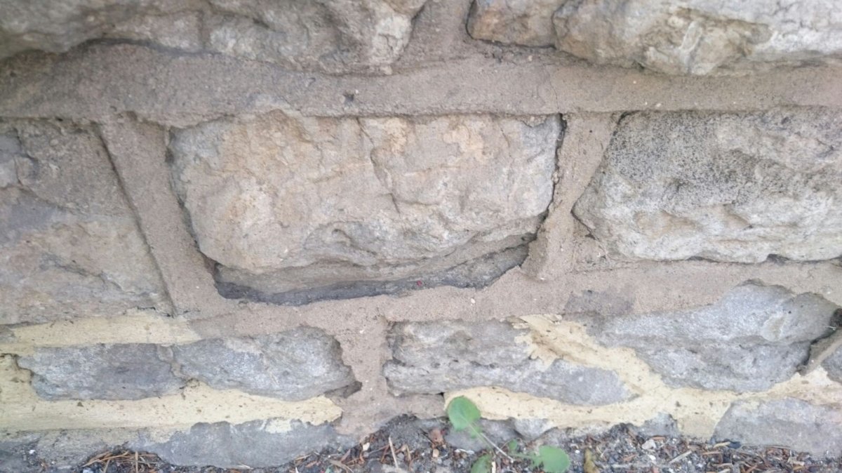

My friend has some damp coming through the inside of his cotttage which has previously had a DPC injected and the inside wall sand and cement rendered. The original contractor who did it says the outside needs re-pointing.
We were going to hack off the inside render and re-plaster with either lime + sand or limelite or izonil as well as grinding out the outside mortar and repointing with a lime mortar.
Does anyone have any hints / tips or suggestions on what to use for the internal render?
