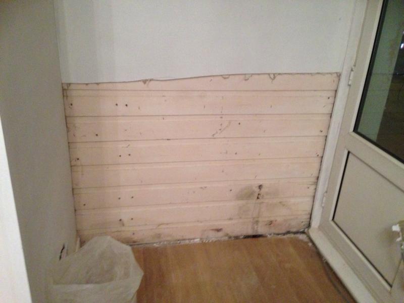

I was in my conservatory today working on re routing a electrical socket spur. When I got the skirting board off, I found there was a lot of damp evidence on the plasterboard behind. So I stripped the plasterboard off, to find the original wood on the brick still, and in a bit of a state in one area.
Noticed that the damp was originating from a broken off plastic pipe - the overflow from the down stairs loo behind the wall!
Pretty shocked that someone thought this a sensible thing to do!
I think I can find a route out through the garage if I cut it and put an elbow in to route through to garage and to outside.

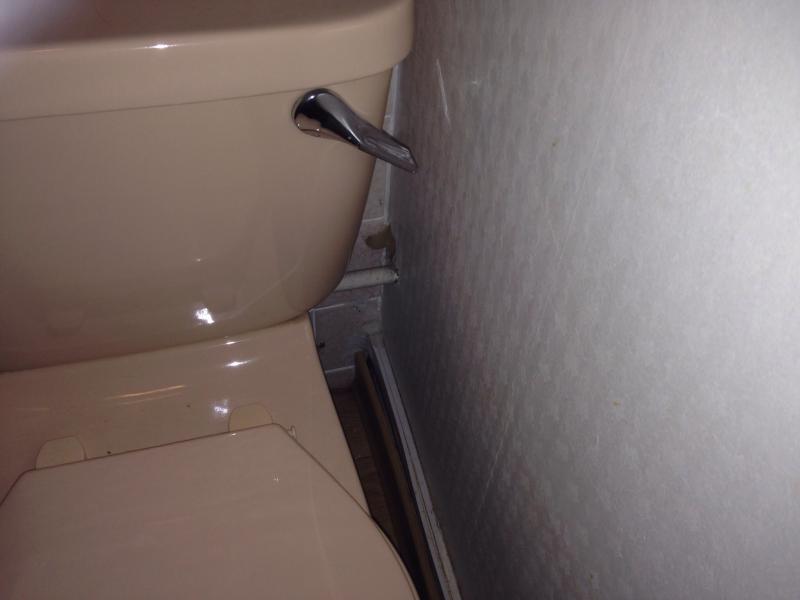

The only opening onto the cistern is where you can see the handle in the pic.
both of these seem to have a push button to activate - does the button go where the handle is?
Toilets I've seen with push buttons before have it on top in the centre of the cistern lid. Sorry - not really done much with plumbing toilets before (if this is a daft question!)
Price wise they seem similar - is one simpler to fit?
Just need to check what kind of flush/fill valve is in the toilet just now, if it's a ball arm type with a syphon flush then you need to check that the arm doesn't stretch over the middle of the cistern otherwise it may foul on the new flush valve.

I think the wall was covered up in 2005, so the leaking hasn't been that bad I guess - considering!
