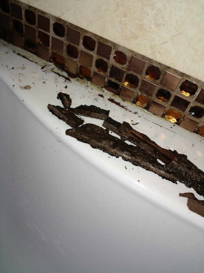

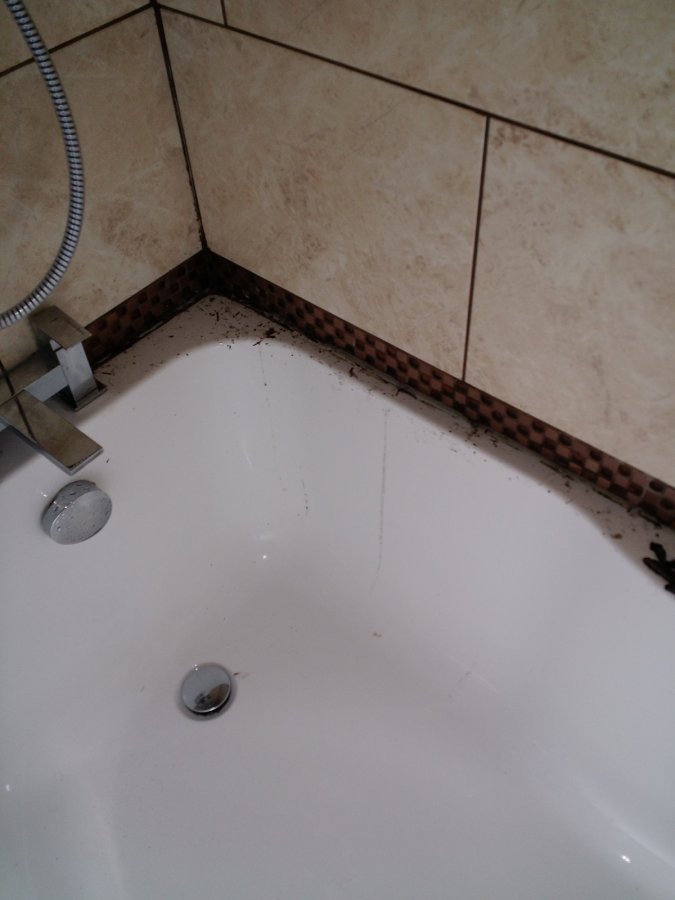

Since we had our bathroom fitted a year ago, the bath has always leaked and the seal turns mouldy quickly. The guy who did the job has since been back and re-sealed around the bath but the issue is still there. So today, I want to try to fix this and I started by removing the old sealant and the grout has pulled off with it
pics attached.

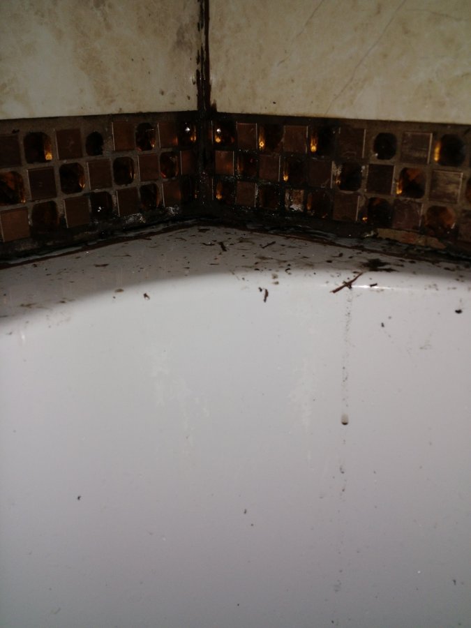

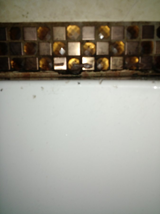

Is it a good idea to have mosaic around a bathtub? I 'think' the water is penetrating through the mosaic which makes any sealant pointless. Everything looks dry from on top but the grout was soaking wet behind the sealant which caused it to snap off with ease.
Should I bother with re-grouting again? What if I just plugged the gap with silicone sealant? Theres 10mm gap from top of bath to bottom of mosaic.
Any advice is very much appreciated!

Clean everything out, all loose grout and blown mosaic tiles; allow to thoroughly dry; rebed loose blown tiles (consider changing mosaics to cut full tiles if you can - reducing gap above bath rim as 10mm is a lot!); if keeping as is then fill bath 3/4 full and apply decent silicone (CT1) against bath rim and wall background; regrout with good quality grout (Mapei etc) leave lowest horizontal line between bath and wall ungrouted - fill it with silicone; consider buying and fitting a bath sealant trim to span gap; with bath still 3/4 full, apply finish silicone bead between trim & wall and trim & bath.
As an extra measure, try and develop the habit of wiping dry the bath rim with your towel after bathing or showering!
I read not to grout the interface between the bath and tile due to slight movements of the bath causing it to crack and leak. On my bath I filled this connection with silicone while the bath was filled, and haven't had any issues.

1. Solid brick walls all sides
2. There is no backer board on the taps side. Aquaboard has been used on the long side of the bath.
3. Standard acrylic 'P' bath and yes, it does flex on the edges if i push down with my hand.
4. No idea.
5. Grout was waterproof and flexi type.

Yes thats exactly what I found that the gap between bath and tile had been grouted then sealant on top of this, although the sealant looked ok the grout had cracked and was allowing water through. I did initially think of buying plumbers gold / ct1 and completely filling that gap up but 10mm?!
Really considering taking the mosaic out, however that tap is butted up against and will have to take the tap off etc. It will just turn into a headache and all the while shower is out of action which is an issue too.
Like I wrote... Don't fill horizontal line between tiles and bath with grout... Use silicone and consider a bath trim to cover that 10mm gap!
