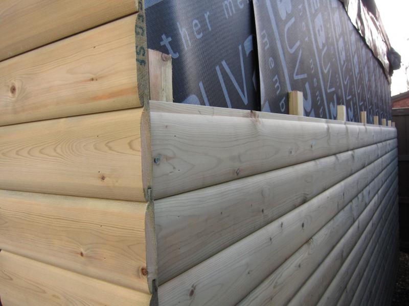

I have purchased 50mmx25mm battens and also WebUV25 Membrane, to complete the task.
Thank you for your assistance alastairreid
This is the garden office wall construction thanks to your assistance.
Just in case anyone wonders why the battens stop short of the top of the wall, it is because some work needs to be undertaken to finish the roof section before the cladding is taken to the top and I wanted decent lengths overlapping the wall, joist, and roof rather than a 300mm piece of batten wobbling about on the top!

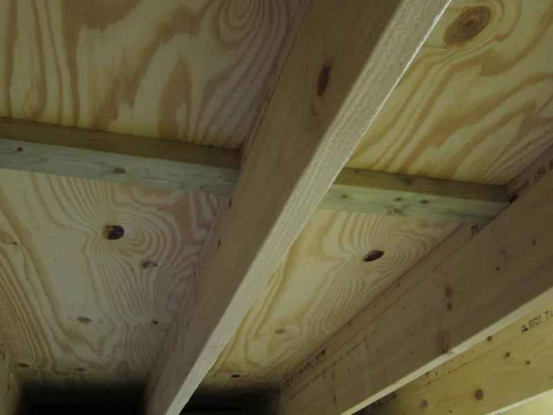

I have the joists and furrings in place with 18mm ply as the roof deck, once complete I plan to cover the deck with Firestone EPDM Heavy Duty 1.52mm Membrane stuck directly to the ply.
Like the walls I intend to use foil backed plasterboard over the insulation.
Where in the roof should I fit a vapour barrier? If at all?
The small noggins are just to support the ply joints, I still need to install the 'proper' joist noggins, that will also support the plasterboard joints.

There are 2 different types of flat roof construction cold deck where the insulation is below the deck.
And warm deck where the insulation is fitted above the deck.
Your construction will be a cold deck! rigid insulation boards would be fitted between the rafters with a 50mm airgap between the insulation and deck, this method also requires ventilation at the facing and ideally at ridge/abutment.
Either that omit the airgap and pack the joists solid with rigid boards and use expanding foam any gaps.
Foil backed boards ..duplex.. incorporate a vapour barrier.
You dont need noggins for the p/b run across the joist staggered is sufficient.
Run 1 line of noggins mid span.

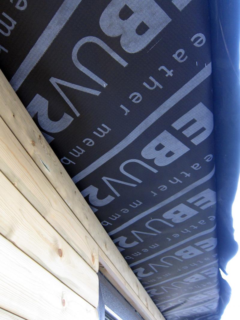

Yes my roof is a cold deck design and will have a 50mm air gap at one end and 150mm air gap at the other end, so a minimum of 50mm gap between the ply and the insulation anywhere on the roof.

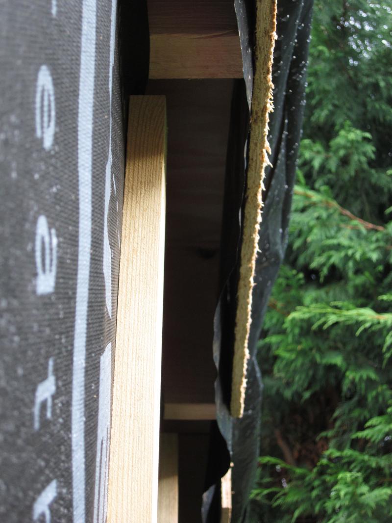

The joists overhang the outer ply wall by 100mm at the rear (bottom of the slope) and 500mm in the front. and the deck slopes from 100mm to 0mm over the 4.8m joist length.
I am still trying to find a nice way to install vents, especially at the front. I was looking at the round 70mm plastic vents, but was thinking of maybe as the battens for the cladding will now be fitted length ways in the front overhang would I be able to fit fewer, say 4 rectangular stainless steal ones over 6 meters as the air can flow freely between joists in the space the battens create.... if that makes sense?
The rear of the building I am looking for a 50mm vent to run along the entire length, probably plastic so this should not cause a problem.
Just to assist with my explanation regarding roof ventilation above.
Front Joist over hang, I assume I will need to trim out the membrane to allow free air flow under roof deck, was thinking of fixing batons along the front and using the cladding offcuts (opposite way to the wall)
Rear Joist over hang, was originally 100mm, but after the battens and cladding it will be about a 60mm gap to fill with some sort of vent.
