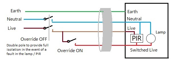

Just to clarify, I want the facility to turn the light OFF if a fault occurs, not to turn ON permanently.
Thanks again.
Having the two pole override OFF switch enables complete isolation if the lamp is damaged or has water in it. Leaving the Neutral connect means the RCD for the circuit can be tripped due to leakage of current from Neutral to Earth in the lamp.

I've now wired and fitted. Via existing DP fused switch. Simple L and N and E.
Switch on ,fine but won't turn off, been on now for an hour.
Any thoughts?
Update-
Any thoughts?
It reads as if you may have connected your live feed to the unit, to the output of the PIR's switched live connection. Does the connector block have four terminals?
Thanks Harry
Yes it has 4 terminals but one L is blocked to prevent access. This one has 2 internal wires connected. I used only the accessible L N E.
