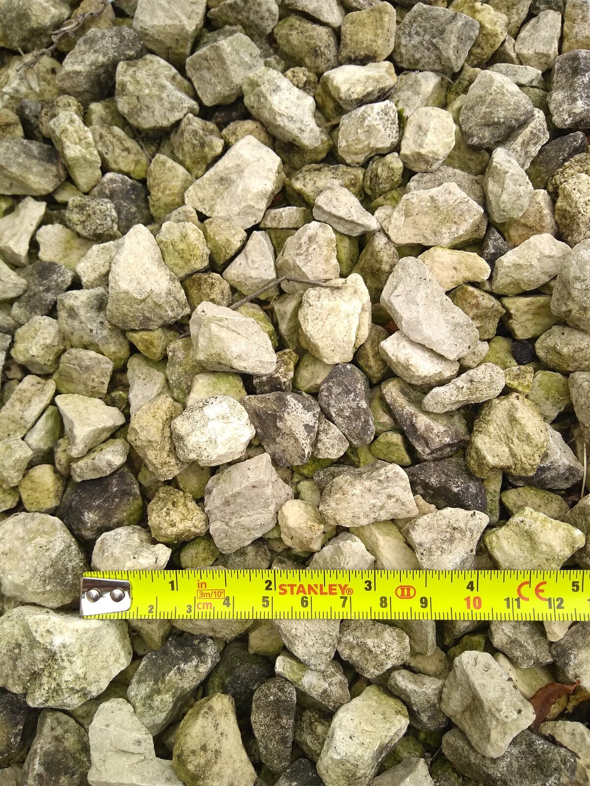

9. For the 100mm bottom layer, does the shape of the ballast matter? I have a load of stuff I'm getting rid of from the front garden. It's flat edged, not smooth and pebbley. Pic attached
Thank you!
I think he was using 5:1 on the mix front, i.e. one cement for every 5 of ballast, the more cement the stronger the mix... but doubt you'd need 3:1 for what you are proposing.
I'd buy a jumbo bag of ballast from a logo builders merchants, they will deliver, cement too.
Doesn't matter what gravel you put in... if you have loads of that, why not get grit sand and make your own concrete using the 'stuff' you have, that's all ballast is, a mix of grit sand and pebbles.
