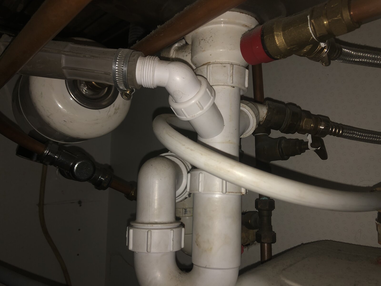

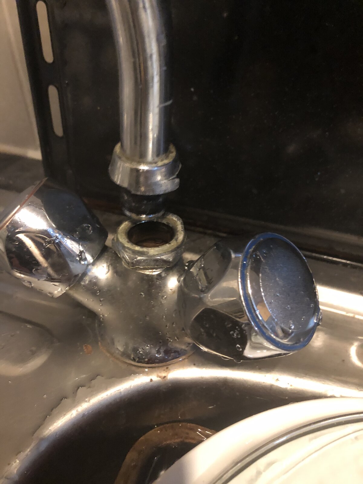

In a small flat my father rents out I discovered today the old kitchen mixer tap spout has broken off. Oddly, it looks like the spout would be replaceable but of course I doubt you'd find anything to replace it with!

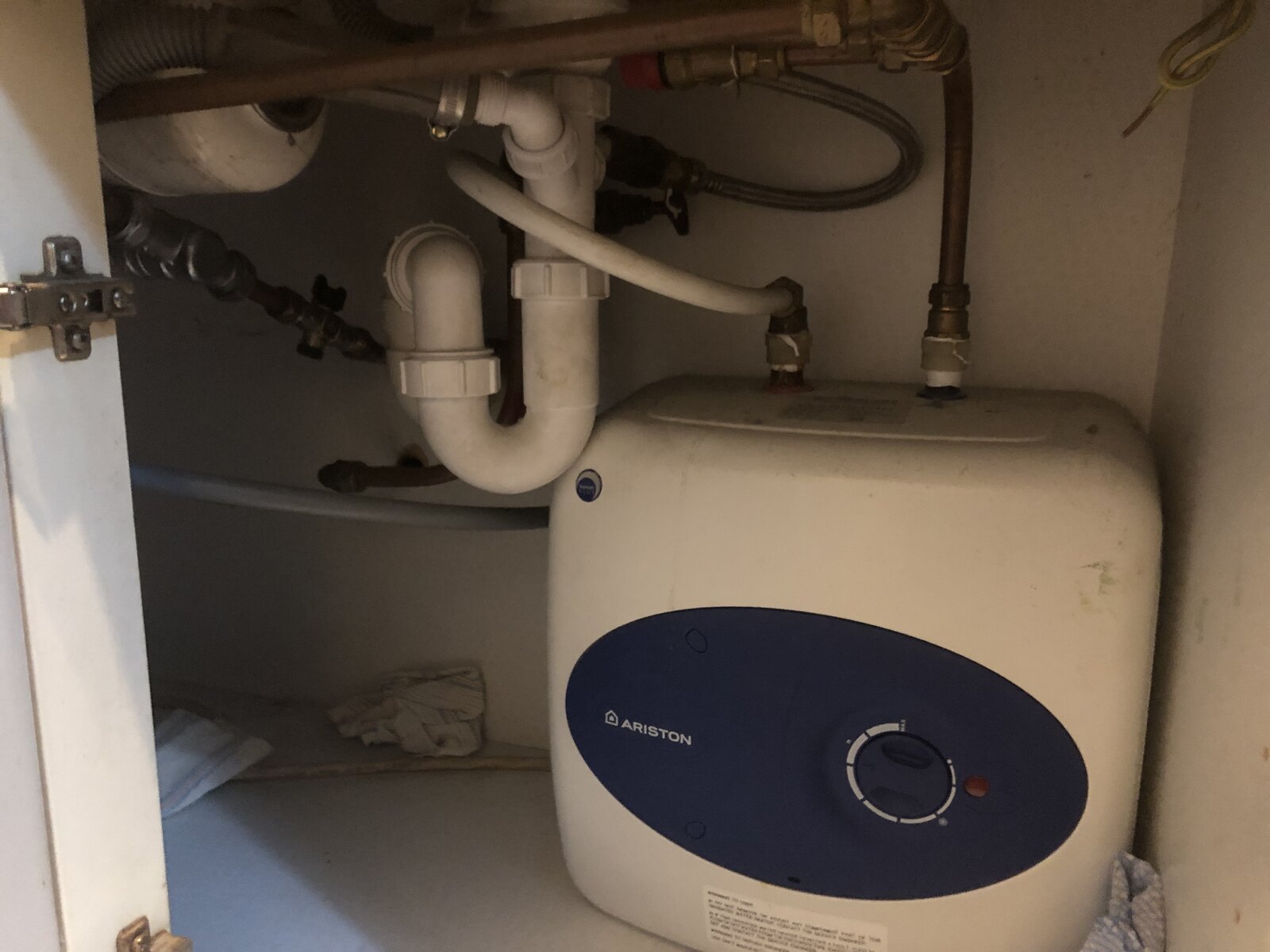

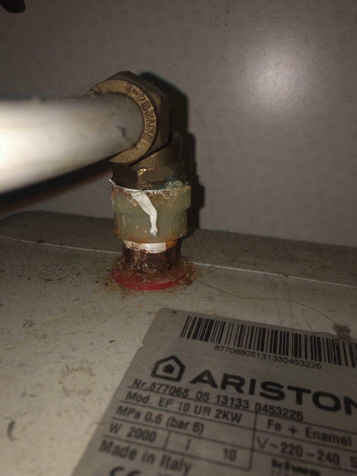

There's a 10L unvented water heater under the sink with a serious spaghetti junction of pipework/PRV/vessel etc etc. Old solid tap tails with very limited access. The Ariston 10L heater is about 8 years old I think. It would help access to remove it and one outlet (the hot I think) looks a bit corroded. I don't know exactly what the white plastic couplings are at the outlets of the water heater (incase I want new fittings for the water heater) Anyone?
If I attempt the tap swap I think taking the water heater out would be best. Does a person have to do anything regarding the expansion vessel when everything is connected up again? TIA.

The water heater install is rough as a badgers arse, however the tap change doesn't look too challenging - Even leaving the heater in situ,
For a ten litre vessel you won't need G3 qualification.
The plastic adapters are to attempt to prevent galvanic corrosion in the heater vessel. Keep them.

Access to undo the compression fittings onto the solid tap tails (or to cut any pipework) really isn't too good. If the water heater was out of the way you'd be a bit better off for plumbing in new tap tails. You could get your head into the kitchen unit a bit better to see what you're doing.
If access really isn't great, you could consider removing the sink - it might seem like a lot of hassle, but it could be an option.
