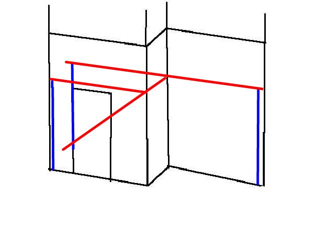

Hi, just wanted to get some opinions. I'm planning to do a rear, 1 storey extension, permitted devt etc.
My original rear wall is not flat but staggered - part of it is set more forward than the other creating a L-shape (or Z-shape, you could say)
View media item 64199
One side is a galley kitchen, the other side is the dining room. My plan was to extend out the full width and also remove the existing separating wall so it's all open. However, one of the builders who've quoted says that the L-shape of the walls above means I can't do that, and I will have to retain some of the original wall as a solid pillar which would end up in the middle of the extension. I can't simply put up steels like a goalpost, due to the step in the shape.
Weirdly only 1 out of several quoting companies have told me this. I see the logic of it but is there any way round this that isn't hugely expensive, or do I just have to live with the pillar?

You could sling a beam sideways across the width of the house and then take a beam from this beam at 90° to the rear of your new extension wall to support the dogleg masonry, then another beam from side to side to support the wall that's further out, lots of beams, probably all quite deep, some columns at each end maybe, all doable no doubt but ££££s. Like this innit with the red as beams and columns blue.

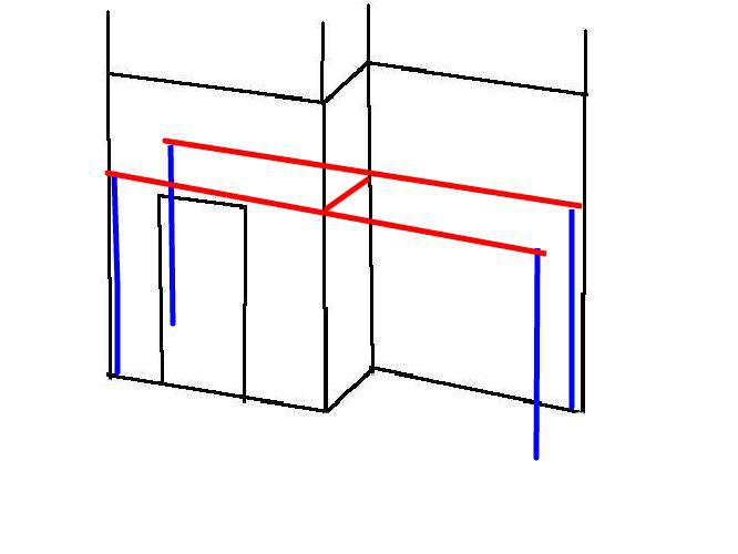

Or maybe just two beams and 4 columns like this:
Or masonry nibs would be needed to take the beams instead of columns. Columns will need pad foundations.
Thanks freddymercurystwin. Yeah it does seem possible - if i go ahead with that builder I'm going to question this.

It's interesting that your architect advises that pillars aren't necessary (assuming that by 'pillars' he means steel columns supporting the beams?).
In practice, that's almost certainly correct and your project would be satisfactory without them.
However, if you have calculations done by an SE and submitted to Building Control, it's possible that the council's checking engineer will bring up the issue of 'lateral stability'. This aspect is raised when you remove a large proportion of a main wall, and usually results in fixing steel columns to form 'goal posts' to enhance the stiffness of the building.
Be interesting to see what your architect and SE come up with here.
I had a structural engineer round and he suggested not having horizontal breaks of 10m as it might result in lateral deflection or something like that - basically when the weight of the beams itself starts to deflect inwards in its own wight and then put pressure on the bifolds etc. I've since told my architect to put a round steel column in. Should hopefully save money too.
