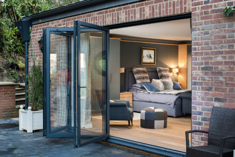

I think i’ll have a chat with Tony once we have decided exactly what we want.
At the minute i’m thinking something similar to this but with a bigger overhang on the roof:
Also if you are having glazing more than 25% of floor area you might find elemental value approach wont work.
Remember that you can add the areas of any windows or doors which will be removed for the extension to 25% of the floor area
to get the total allowable glazing in the extension, so it's potentially a bit more than 25% of the floor area.
