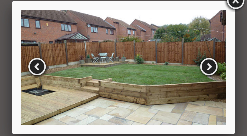

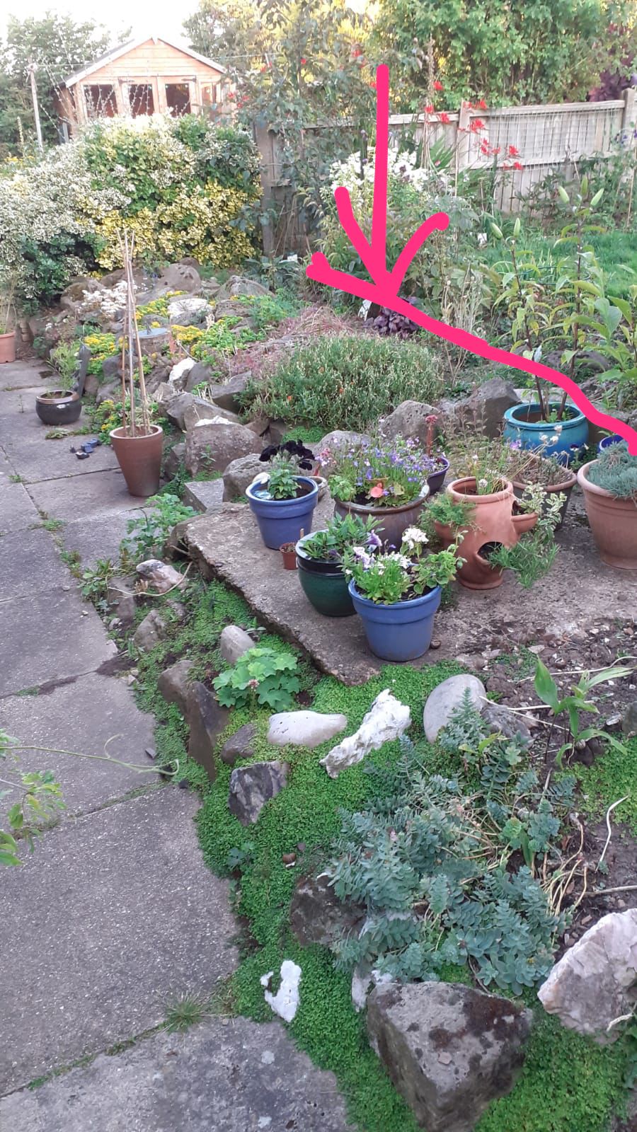

Want to get an idea of what a garden landscaping job like this would cost as my mums been quoted £8.8k with VAT and think it’s steep. What are ballpark figures to expect for jobs like this?
Located in midlands
Job description:
Clear away those slabs, and rockery up to where that line is on the photo and add in a retaining wall with steps then replace the slabs with sandstone pavers then add some slabs up to the shed in the garden. Finished project would be similar to the other photo added. Company that quoted offered to reuse stones in rockery to bring down the quote.
