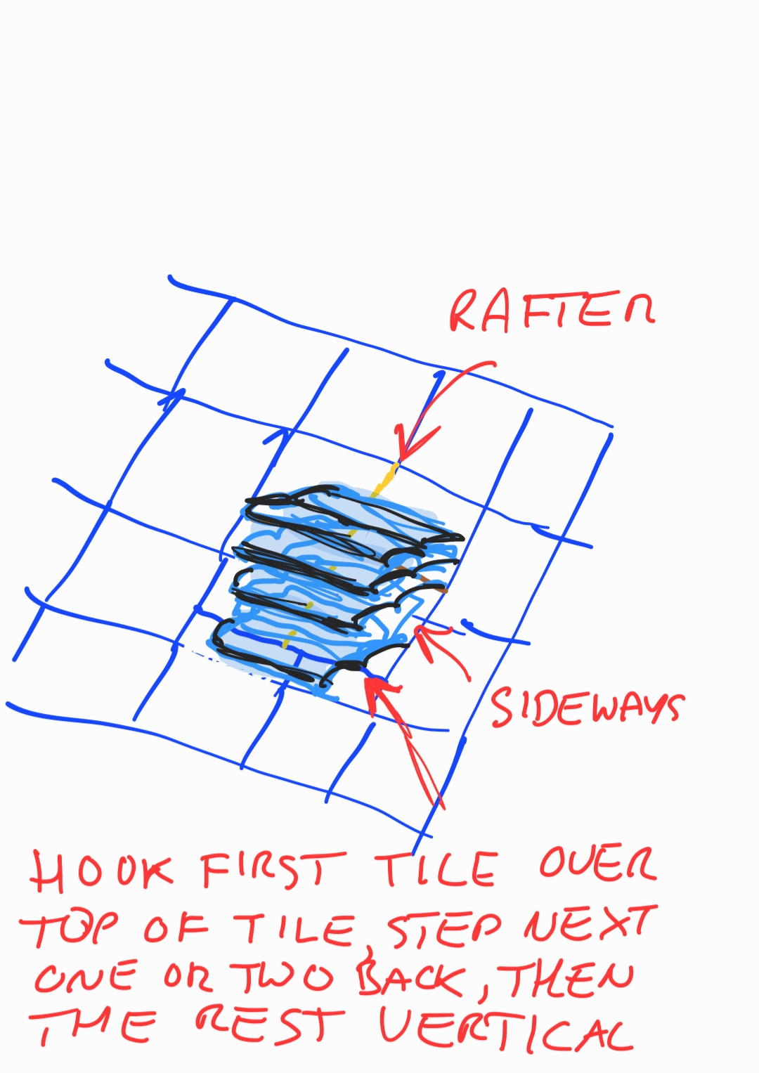

Any tips for storing the tiles? Also need to check for nails in the rafters when I pull the battens out :/

For the tiles, you would kick two or four up over a rafter, and then drop one or two sideways over the top of the tiles with the groove of a tile acting as a hook, set one or two back and then the top tile becomes horizontal and you can then stack many more on this. Make sure this is done over a rafter and just down from where you are working.
It's a bit hard to explain, but if you google for "tiles stacked on roof", you will only get new roof work images, but this is the principle
Ah yes that makes much more sense. So just use the batten as a helper to catch it and use the rafter to hold the weight.
