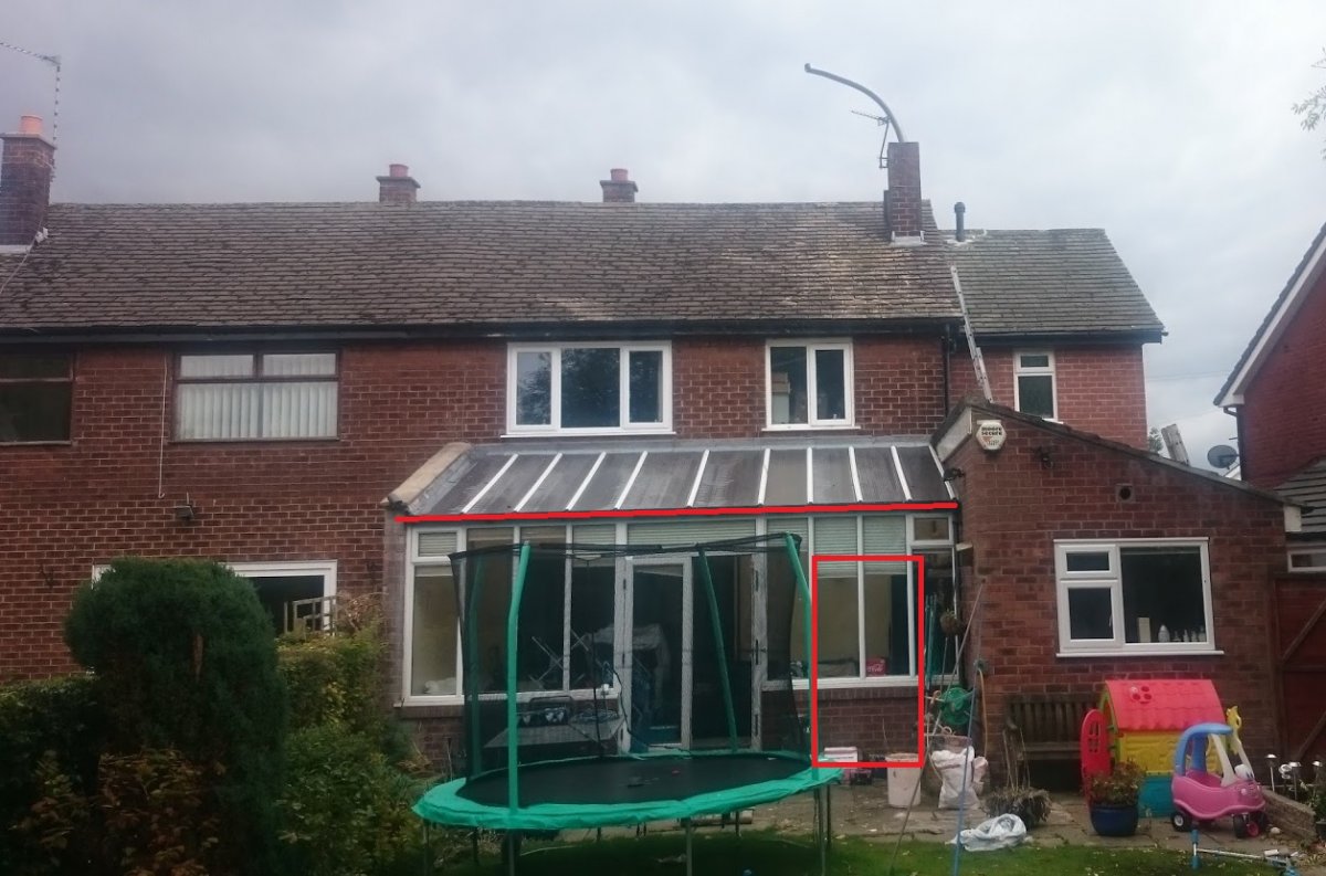

Thank you for your reply Frank!
Ok, so my current construction is uPVC as can be seen in attached photo (poor one at that)
The new roof i have in mind:
Timber wall plate bolted to the existing house wall.
Timber rafters to either a timber wall plate if can sit onto of frame or to an RSJ
Kingspan or Celotex 70/100MM insulation for between rafters at 500ish centers
Two Velux windows - not sure on sizes yet
And to save on cost and weight shingles to match house tiles - best i can find.
As can be seen in the photo i want to move the door over to the right side of the room to maximize usability of the room
I was hoping to use the existing wall to the left and also run at the same pitch as too keep in check with the kitchen to the right.
