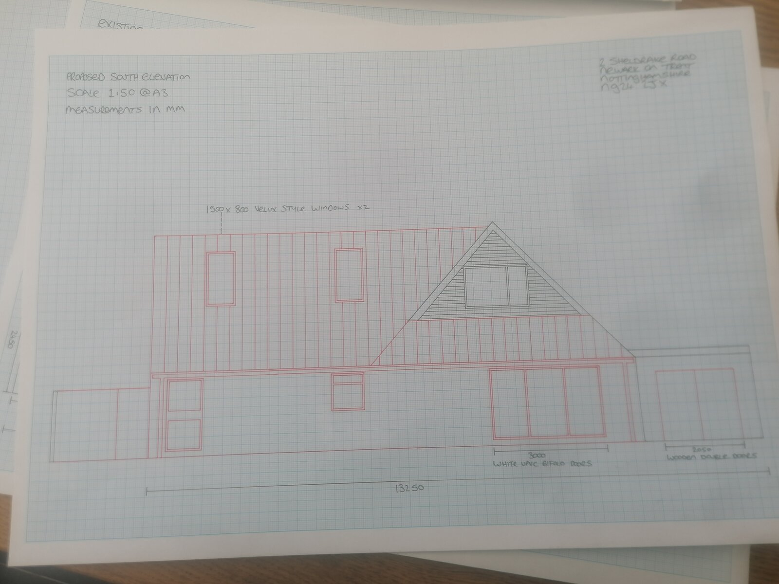

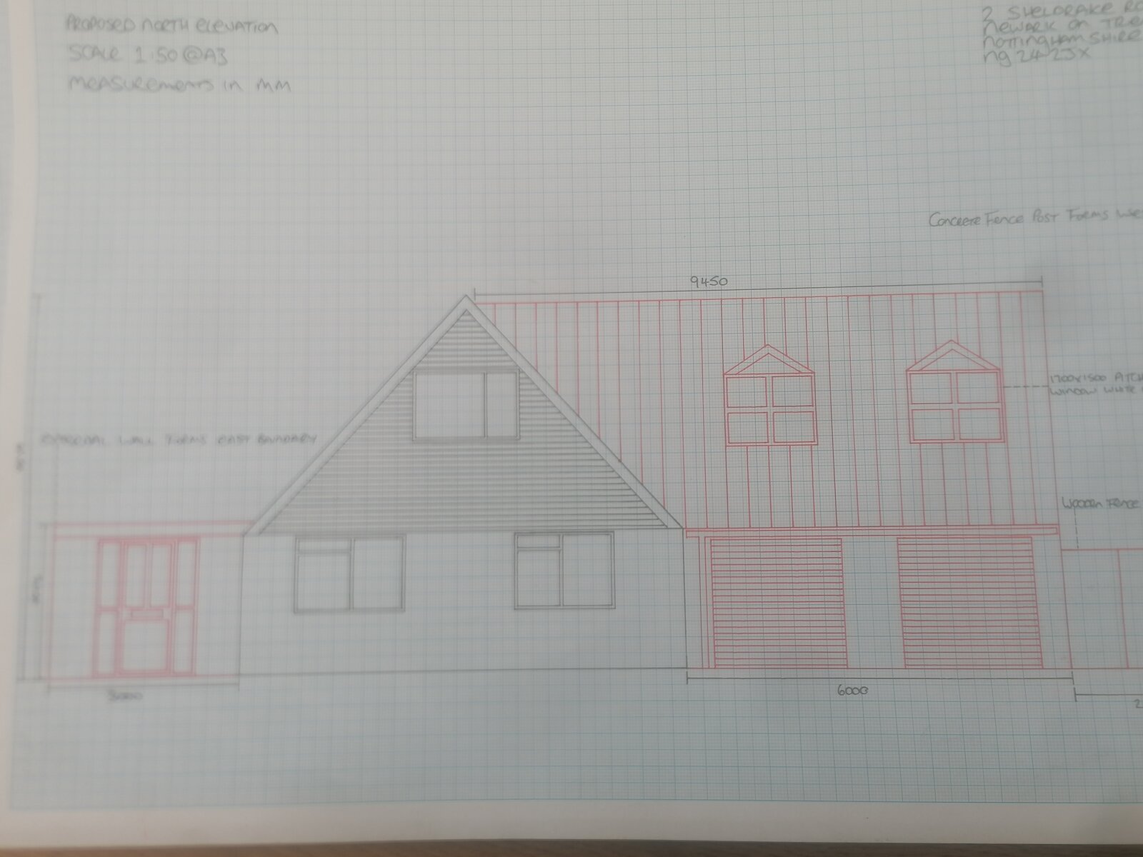

Hi all,
Received planning permission today to build the attached extensions.
The foundations, block work and roof are being done by a friend who is a builder with me labouring for him and I'm picking up everything else.
As I understand it I can either, do the work under a building notice which means we will receive a limited amount of site visits from bc and relies on things being done properly between visits or I can draw and submit full plans to bc and they will point out any issues before we proceed.
Either of the above will require me to get structural engineering calcs for the steels needed, I'm happy to go with a building notice as I've known the builder a long time he's a family friend and I've done stuff with him before.
Apart from getting calcs and a building notice in what other things do I need to be getting squared away?
I know ill need to move the main drain so need to go through the motions with severn trent for that.
Our water meter will need to be moved and the water supply pipe with it as the wall there both on is being removed, again I assume I take this up with Severn trent?
Chris
