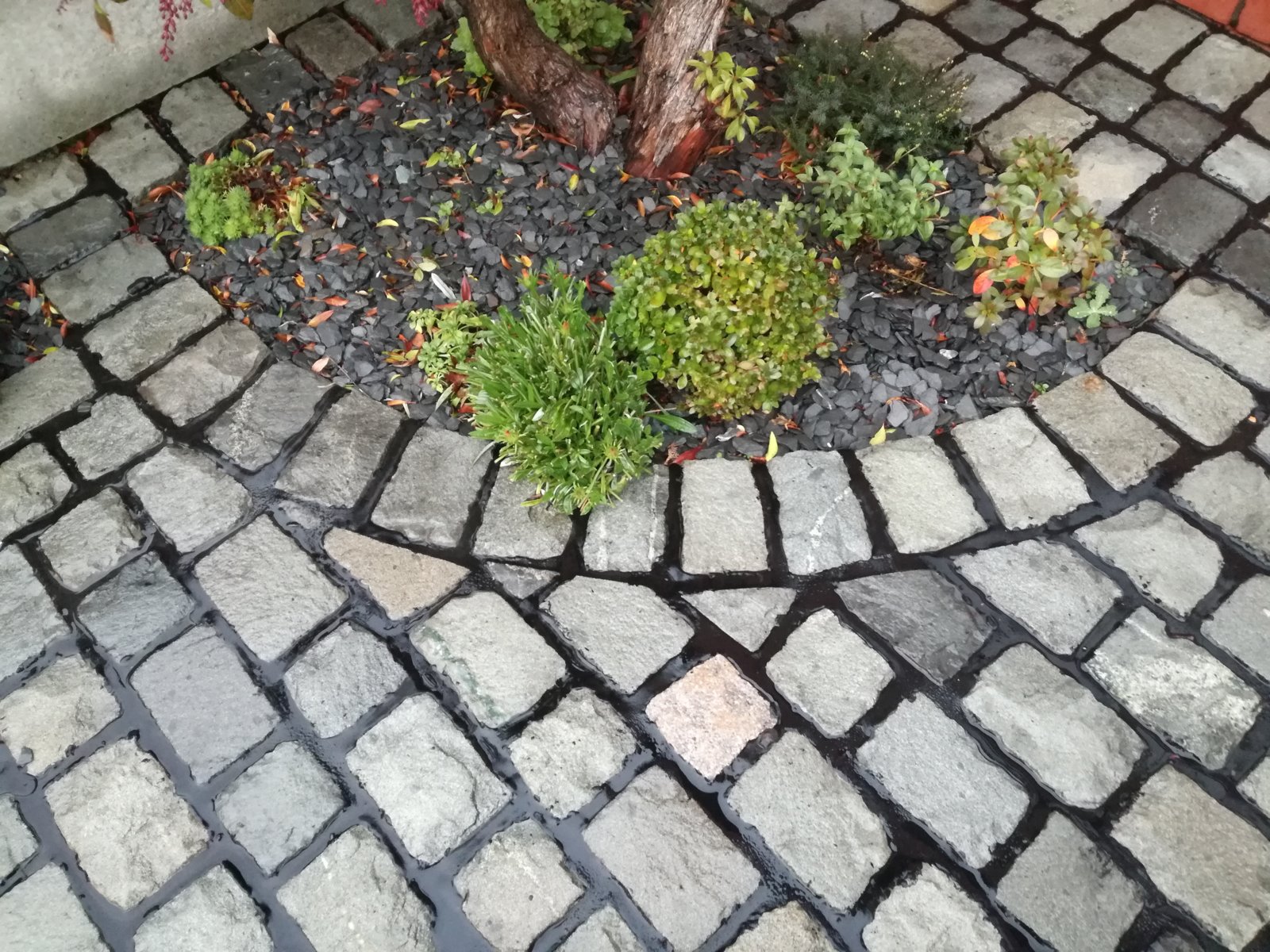

After searching the country i found these stones locally /

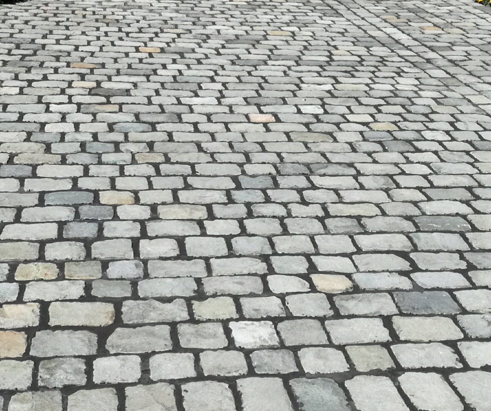

Decided to construct the drive to a carriageway specification as essentially thats what it is , was an excavation of 450mm .
Took weeks to clean , gauge , row , patern and lay the stone but I got there in the end
Pitch jointed using a filled modified carriageway bitumen
You will know if it is a good one when in the middle of a good going heat wave you have small bitumen bubbles start forming between the Setts [ the Scots word for such blocks, up here they are generally Granite.]

This is the product I used
http://www.colasproducts.co.uk/bitu...oducts/bridge-joints-and-sealants/sett-grout/
DIY, using a roofers boiler was fun heating it to 210C to achieve a 190C pour .

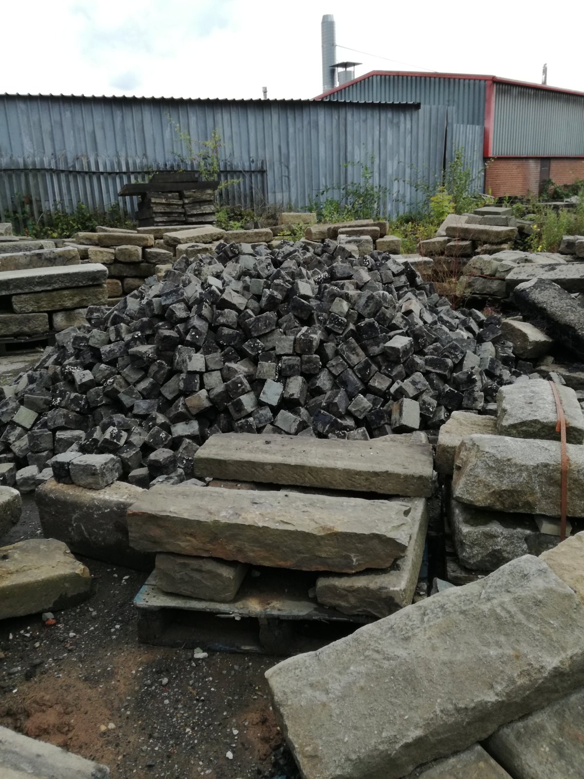

They look clean the stones in the pile , the weathered ones on top were ok ish , however they had been covered by carriageway several times over the years ,black goo on the surface , horse shoe stuck to one of them an the reality was 3 weeks just to prep for laying .
Started off as 11 tonne of scrap

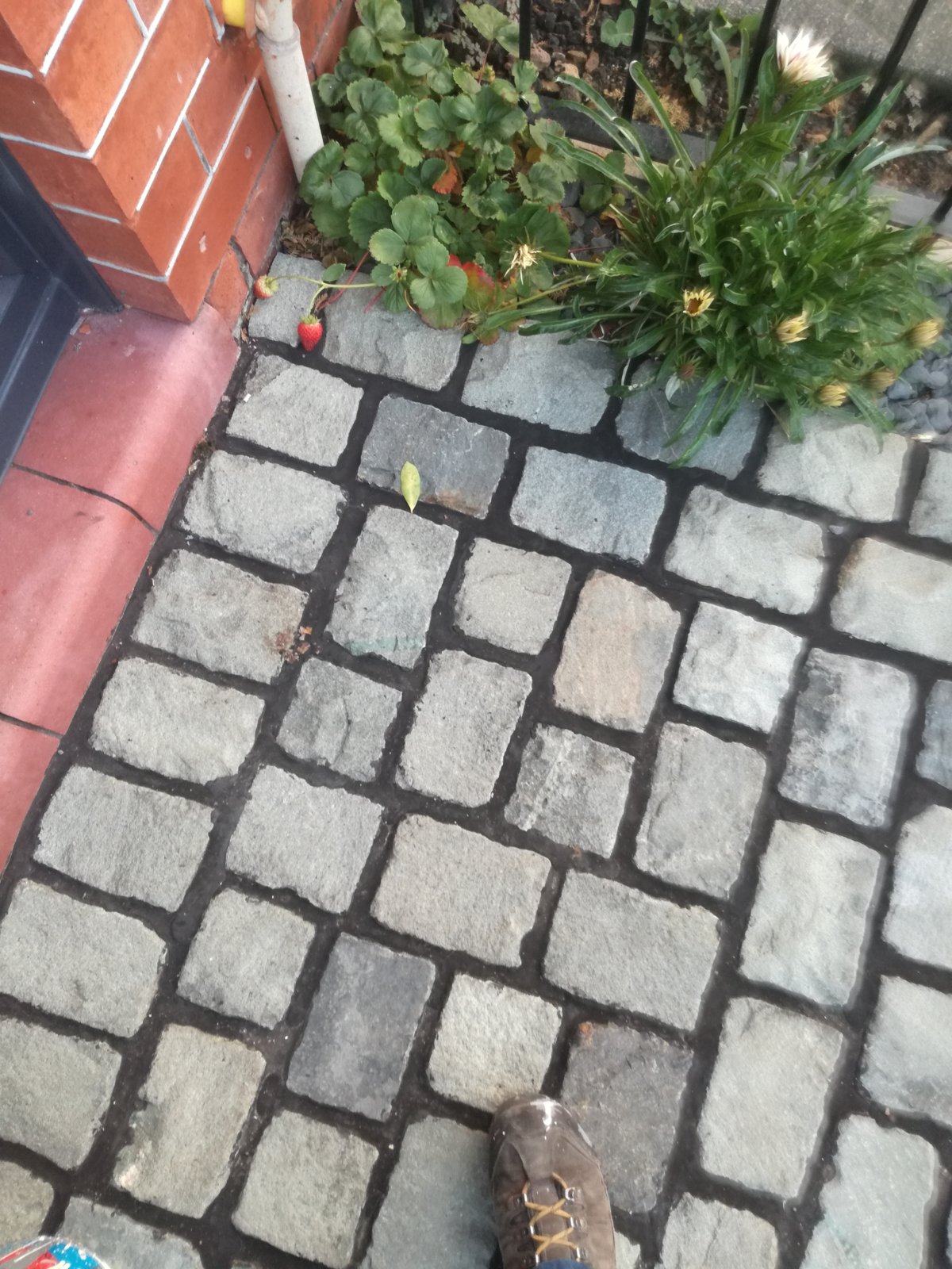

£300 was random lay no pitch joints .
Hand cut stones from a while ago , width alone the 4 inch was from 90 to 115 , my joins would of been all to pox unless carefully rowed out
The biggest set back was the cleaning prior to laying , had to hand ball them round the back of my house , nearly sent them back , then decided was going to be unique kind of so stick with it .
However this gave me the opportunity to lay the lot out at the back of my house to see every stone and pick the ones I wanted .

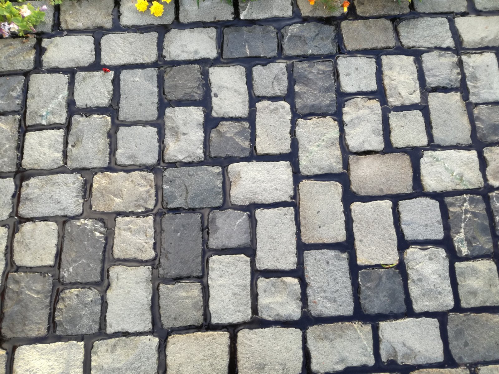

Bought a proper pitcher & a set of bushing hammers would of been a nice addition to my kit , was to expensive for a graded set.
Is only one stil saw cut in it all was a diagonal.
A few tools could resurface the bad stones , took a lot back with jack hammer damage etc .
