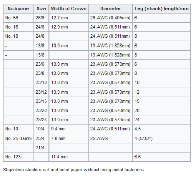

...why so many different references for the same product?
I think it's down to different manufacturers trying to protect their own market share, so you'll find Arrow, Bostitch, Tackwise, etc "own brand" references as well as standard references. There's a useful table in this Wikipedia page:
Some of the narrow crown stuff I've used in the past has been a headache to source as there are so many sizes out there
