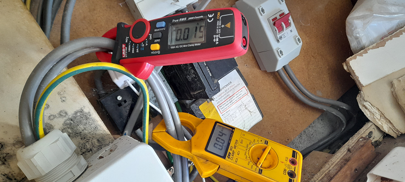

I selected these
the upper one is new, the lower one bought many years ago when working in Hong Kong before the take over, and clearly from the reading, now past its best.
But I will say why I selected the UT210D as my replacement.
1) It can measure earth leakage. As shown in picture.
2) It can measure both AC and DC current.
3) There is no way that selecting wrong range can produce a short circuit.
4) The clamp means I can hang it on something to measure volts without holding in my hand.
5) It has a 4 stage non contact volts range.
6) Small enough to carry anywhere.
7) Cheap, it cost me £35.
The DC current needs zeroing, and although it can measure 1 mA DC, so easy to move meter so the reading is not accurate, to measure the 6 mA DC leakage current is a bit hit and miss, but once measuring over 10 mA no real problem, I used these
for years to measure DC amps, and the clamp-on is so much better, and cheaper.
Today I wonder how in the early years I got by without a clamp-on multi-meter, be it testing for a borrowed neutral before disconnecting, or tests which could be done wired.
The old yellow meter also measures frequency, handy to set speed on generator sets, I still have one of these 1722852261751.png not used in years, not sure they comply with GS 38 no one considered that in the 80's when I got mine.
However the leads for the red clamp-on did comply, you need to consider when getting a really cheap meter, the cost of GS 38 leads, looking at an advert for leads, and they cost more than my meter.
