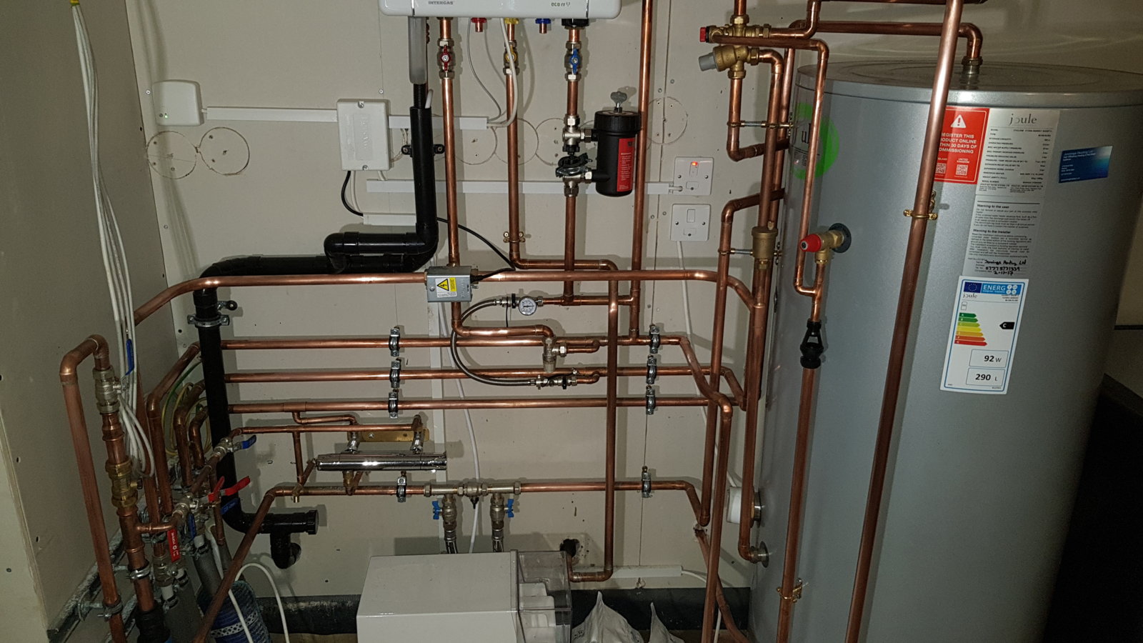

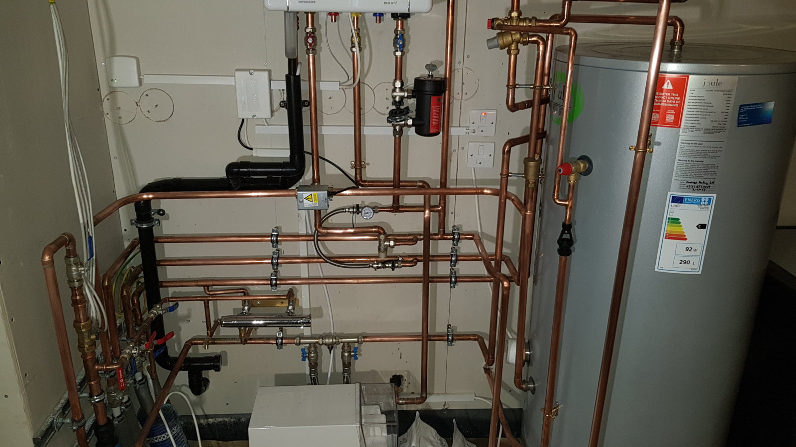

Most DIY'ers use too much heat for too long with too much flux slathered everywhere. You just need a small amount wiped on the pipe. NEVER in the fitting.
Thanks Dan, sorry for slow reply never got a notification either from the app or E-mail, that's impressive pipe work I will not flux in the fitting
