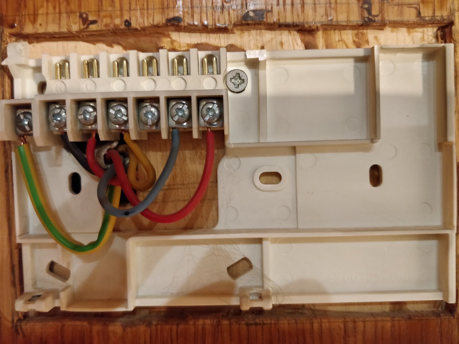

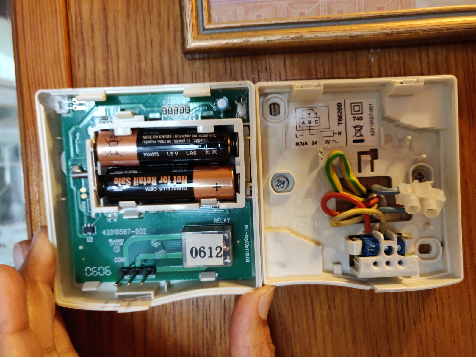

My aim is able to see what room temperature it is and set the required temperature when away from home.
My setup is Greenstar 30CDI System boiler, separate hot (middle floor) & cold (loft) water tanks, gravity fed.
Currently have Honeywell Home Thermostat DT200 = T6620B1008 (battery powered) & Honeywell ST9400C Programmer, see photos for wiring setup
Appreciate recomendation for a simple replacement of the thermostat with minimum wiring change.
Or would it be better to change the programmer as well?
We have Wifi in the house
Many thanks

Hive? The room stat replaces the programmer. The wiring is easy - I think the wiring is the same on your programmer as the hive - mine was anyway. Plenty of knowledgeable members on here that will help you out if you have any problems. You'll need the hive hub as well If you want to control it away from home. If you have a hot water tank you’ll need a dual channel kit.
I believe this is the kit you need and it comes with the hive hub.
By the look of your wiring it looks like you have a Y plan system, there are many internet systems but you will require a Dual channel unit, like Nest or Hive and not just a thermostat unless you want to keep the existing programmer and just change the thermostat then look at Nest E
Hotwater will be off when away from home, so no need to control this.
That may be so but its nice to be able to turn the hot water on before returning home.
Any of Hive, Nest, Tado or Wiser would fit your needs. However Hive or Wiser are easier to install as their wiring is identical to your existing setup, you may even find either fit directly onto your existing back plate. If not it's a simple swap.

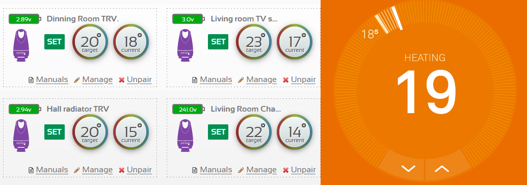

The Energenie MiHome TRV's can also be set up with IFTTT to auto switch between two settings using geofencing. It does not need to be the wall thermostat.
In the summer I look at the TRV Heating not keeping up.jpg and if the room is too warm, I turn on the AC unit, so I can use the information to manually turn on devices.
It seems some geofencing allows you to set distance from home at which it turns on. But in real terms, when I come home, rooms are not all used together, likely only kitchen and living room for quite some time, I may latter want to use craft room, office or bedrooms, however my boiler is simple on/off, it does not modulate, with a modulating boiler room by room control is a better option.
