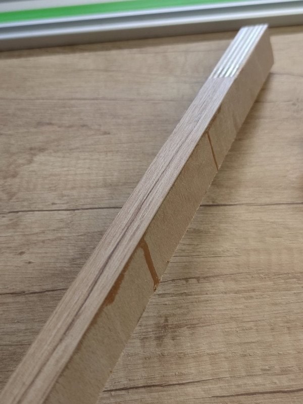

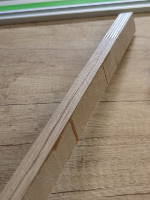

Just tried the virutex on a scrap bit of ply and results are great.
Thanks again!
