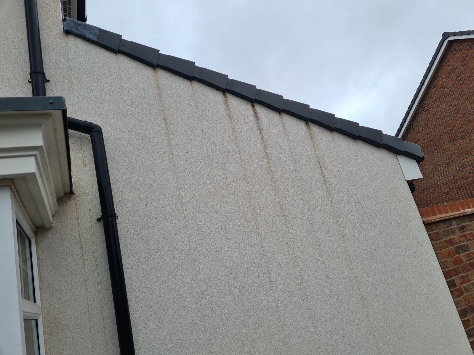

Hi,
We moved into a new build 2 years ago and we get these horrible lines down the wall. The new build have looked at it and said there's nothing that can be done, does anyone have any ideas?
Re removing the existing stains, if you Google remove stains from render you'll find various advice and tips.
They have not used stainless steel screws when fitting the plastic verge.
Sort the screws out and wash the wall with a rust stain product
Thanks for the replies.
Do you think that's the problem? How can you tell they haven't used stainless steel screws?
It's not rust as others have said it's crud from the roof leaking from the units .
That's why I suggest continuous ..no joints .
