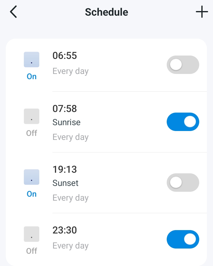

I use TP-Link (Tapo) smart switches as they have batteries in them so don't need a neutral or any power going through the bulb, and have the option of dusk and dawn switching, work with Nest mini's with voice commands, and the google Home app on phone, but does need a hub which needs to be plugged in some where, but not hard wired to LAN, and hub can double as a door bell. I have needed spacers with some switches with shallow back boxes, but the fact I can use them on PIR controlled lamps is very handy. Batteries can be renewed without removing switch, but as yet never needed to renew them.
Example of settings 1706636966801.png at moment not using the option.

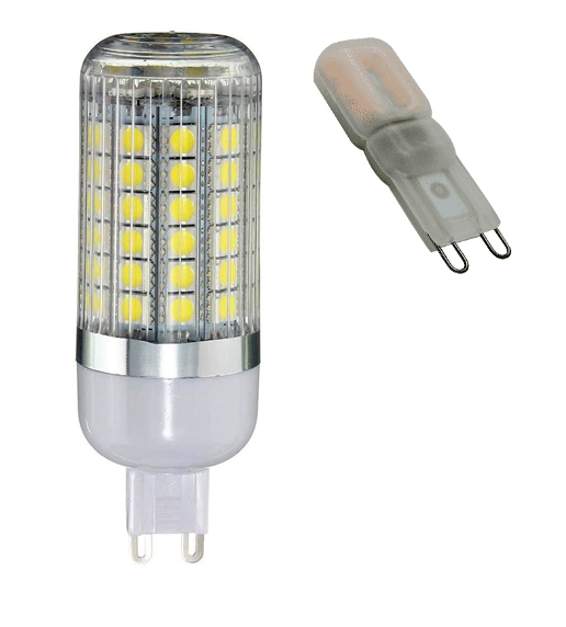

But big down side was although did not need a neutral, some bulbs would flicker when on and stay on very dim when off, the load capacitor cured staying on dim, but had to use different bulbs to stop shimmer. Although both G9 bulbs size very different G9-comp.jpg so the covers would no longer fit, so whole chandelier looks very different, lucky wife likes it.
