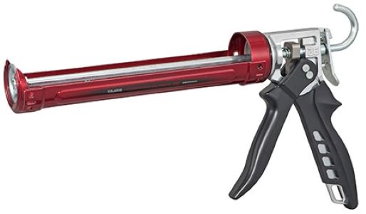

Time has come to fit another mile of skirtings/door trims and felt I should buy a decent silicone gun for the adhesive and caulking.
I don't need any fancy expensive battery powered one but something a little step up from the cheapies you pick up for under a tenner that don't have any action to stop the flow after use.
Something around the £20-30 range that would last me for a few years and is easy on the hands.
Apologies as I know there has been some recommended in other threads, I had a search and couldn't find it though.
Go for a heavy duty gun. My personal favourite is the Tajima Convoy 26

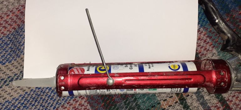

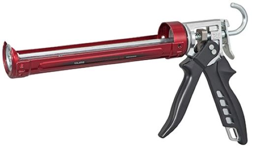

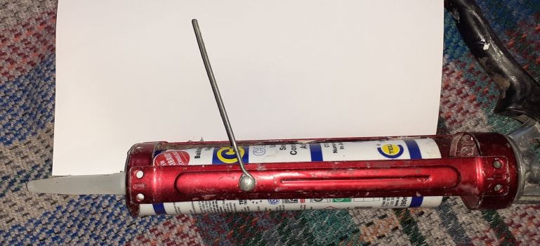

because they are durable and comfortable, although there have been one or two adhesive cartridges they won't accommodate (always the glue tubes with spiral wound cardboard tubes for some reason - on the rare occasions I get those I just shorten them 10 to 20mm with a Stanley knife). Better guns have rotating bodies and some way to clear a blocked tube (often where the cointents have set). This is the inbuilt "poker" on my Tajima gun:
As you can see, my gun is well used. It cost about £22 new a few years back, but it is a high ratio gun. If you prefer a lower ratio gun (in other words a gun with less pressure behind the nozzle, so OK for caulk) you can pick-up a Convoy 12 for under £22, delivered, on eBay at present. The Convoy 26 is a better gun if you use a lot of dense materials, such a GripFil, heavy-duty mastics, etc
There are other heavy-duty guns that are worth getting. I've had both Cox and Ox h/d guns in the past as well, but I'm sure someone will recommend something else. Just avoid the cheap, lightweight skeleton guns. Never had a go one of those, yet

I'm not sure that will work the way you think it should. The materials in the tube are generally compressible, so if you pull the trigger, you will compress the contents of the tube (and drive it out through the nozzle). In reality you need want the plunger to go forwardswhen you pull the handle, but not come backwards when you take the pressure off, that way you can maintain fairly constant pressure (and therefore a consistent flow/bead size). That means at the end of your bead on the workpiece you really need a gun where if you depress the release lever (at the back), the pressure will be relieved and flow will stop. All the heavyweight guns I've used have this, but all of them require action on the part of the user to make it work - AFAIK the only guns which don't are the cordless models, which use a screw thread to drive the flow and auto reverse on a timed cycle (?) to prevent drips
