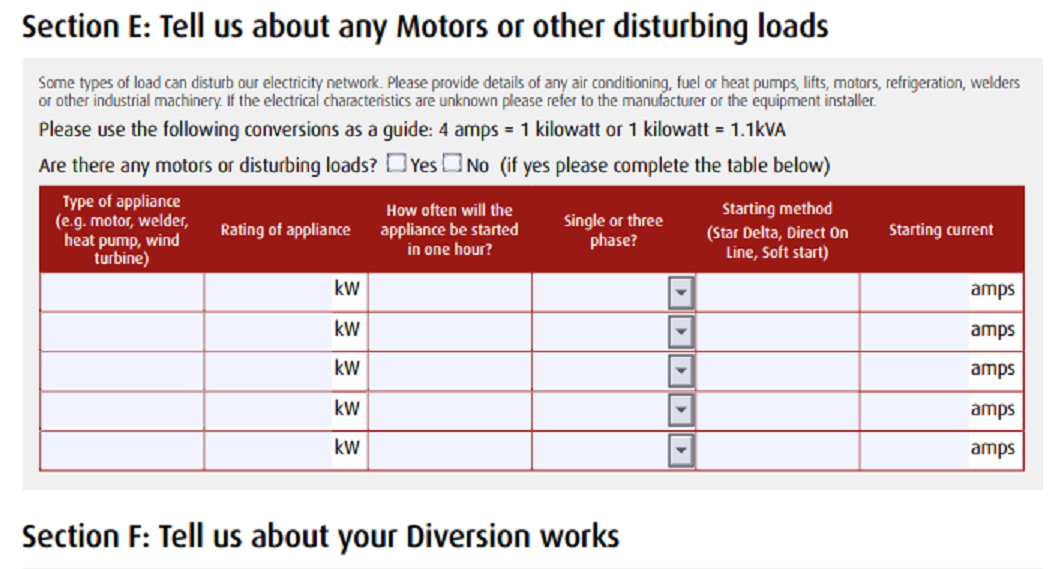

It's not so stupid. You are probably in contravention of your contract with the electricity provider if you haven't informed them of this, and they are entitled to cut you off if you cause any problems for others.
Also from https://www.ukpowernetworks.co.uk/i...an_electricity_connection_projects_online.pdf
