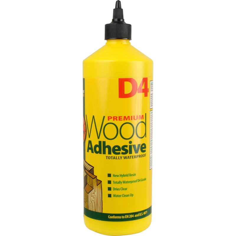

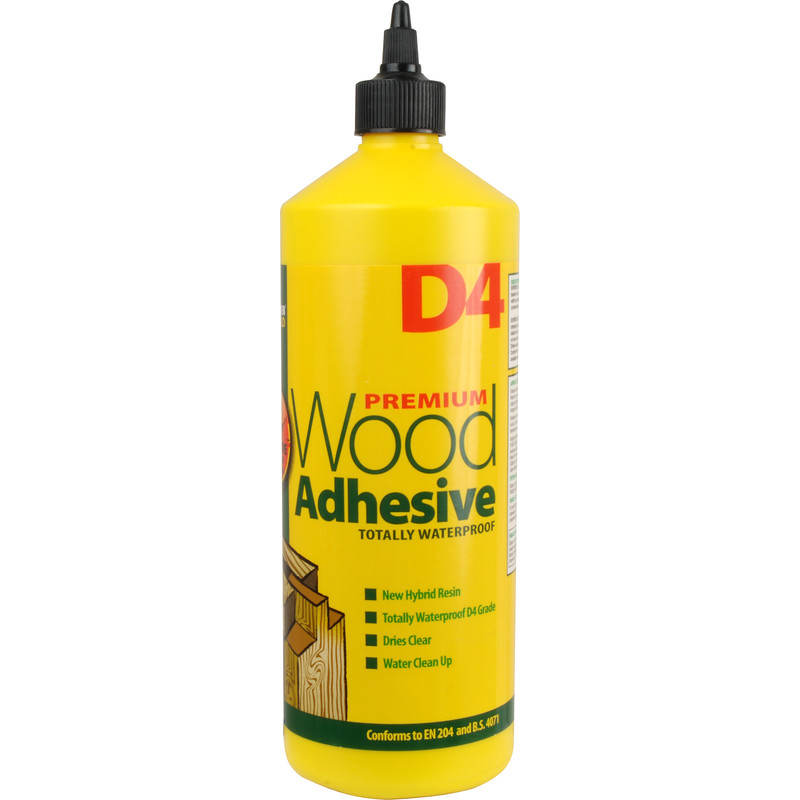

Nothing wrong with Evo-Stik Resin W (the green stuff you were referring to, I think) although for most joinery work these days I tend to use either the blue version of Resin W (which is moisture resistant) or often, now, this stuff:
EverBuild D4 Wood Adhesive, which is a cross-linked D4 glue and useable outdoors as well as fast setting (possibly too fast for repair work).
If all you are doing is indoor work and the furniture isn't going into the bathroom or kitchen then a good alternative is Titebond Liquid Hide Glue, a modern version of the old hide glue which can be used cold. It sets slowly, giving plenty of time to position joints, it fills gaps (important in repairs) and it is reversible if things go wrong and you need to take the piece apart again (D3, D4 and poluurethane glues such as the original Gorilla glue don't allow this as they are irreversible when set). I carry a tube of that when I'm out and about doing repair jobs for just the sort of things you were talking about
