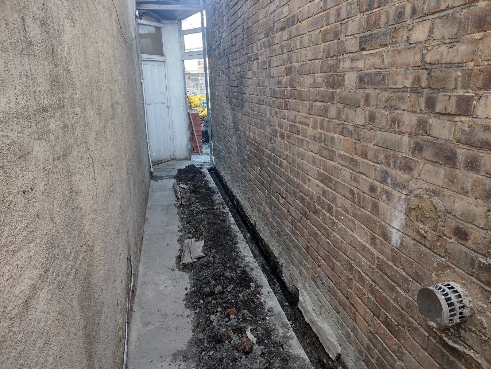

Gable wall has internal damp which appears to rise from the ground up
I identified that that the existing floor outside (concrete) was at least two brick courses above the DPC
So I've made a chase and dug out the concrete
I have gone two brick courses below the DPC now
Now is it best practice to install a membrane to prevent weeds and then add gravel/ pebbles?
Or is it best to install a French drain?
Not 20mm gravel, after a year it compacts back to solid again. Really you could do with large pebbles... like you get on a beach, air can circulate then... shouldn't need membrane.
I don't think it seems wet enough for a French Drain.
What was your solution @veedee as I am doing the same to my house at the moment? Thanks in advance
Hi @Nick2847
No french drain needed. I confirmed with my builder friend who does this all the time.
He said that a membrane was not necessary, but for my own sanity and for a little bit of money I installed one.
Just make sure that you buy a good membrane, that prevents weed growth but allows water to get to ground
I finished the job off with pebbles
