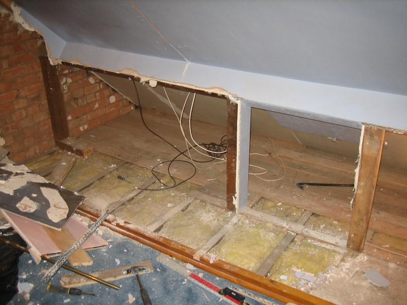

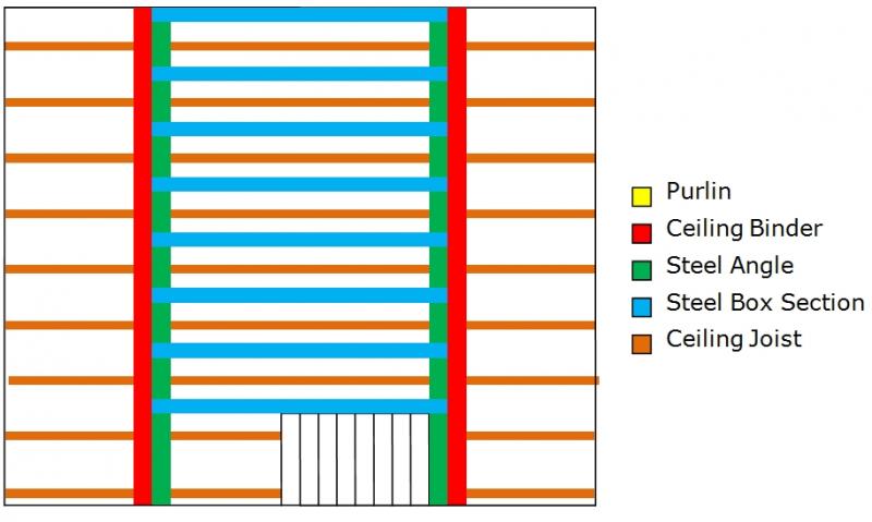

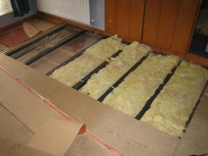

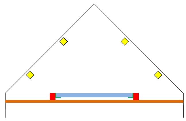

Last year I bought my first house, a nice detached 1930's place with a few problems due to the previous over ambitious DIYer, the biggest of which is the loft which isn't to building regulations, and basically needs ripping out and starting again (confirmed in another thread I started last year). I've attached a few pictures detailing the current construction, they're not to scale however. It's a strange arrangement of angle steel bolted onto the ceiling beams, with steel box section welded onto that, this would never pass building regulations so needs completely redoing. The existing room is fairly cosy at 4.5 x 3.1 x 2.0, but I think it would make a nice guest room (or cinema room :p)

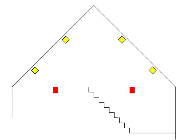

It should be a relatively straightforward conversion, since I'm not modifying the roof structure, and there's no party walls, however there's insufficient headroom for the staircase at the moment (only 1.67m), I can easily bang my head on the binder above the stairs, and I can't move the stairs forward as it would cut across a window on the 1st floor landing. I think the basic order or work would go something like this:
- Remove existing steels and staircase
- Fit 2 x RSJs parallel to the binders
- Tie ceiling joists to RSJs to take the load, then remove the binders
- Fit floor joists into the RSJ webbings
- Fit staircase
- Sort gable window (this worryingly looks like it's been built without a proper lintel!!)
- Fit roof windows
- Fit insulation and fireproofing
- Rebuild stud walls around landing
- Electrics, decorating etc
By removing the binders, I think I can get the required headroom for the staircase, has anyone seen this done before? Obviously I'll be getting proper calcs and plans made up, I'd just like an idea of whether this would work.
Also, does anyone have an idea on cost for doing the structural stuff (fitting RSJ, tieing to ceiling joists, fitting floor joists and removing binder)? I plan on doing most of the other stuff myself (except for the staircase and gable window), so it would be the main cost in this conversion.
Thanks :)
Bit late for that lot, but 1 question springs to mine. If the previous roof supports have been removed, what's holding the roof up? Purlins usually need support from struts or stud wall in the eaves.
The lower purlins may be supported by struts, but I need to remove some of the plasterboard to find out (will do that this weekend). The upper purlins appear to have no supports (other than the gable walls), it's possible they were previously supported by the partition wall that runs most of the way down the house, I'll investigate that this weekend too.
If there was additional supports there before, what could be done to remedy it? Obviously adding struts into the middle of the room wouldn't be suitable, can the purlins or rafters be reinforced?
Do you know what's supporting the ceiling binder underneath?

As for the structure, I don't think there's anything below supporting the binder, it's just supported by the gable walls. They're a reasonable size, about 6" x 3", with a 4.5m span.
When you say you had stress load calculations done, I presume you mean you calculated whether the existing joists were suitable? Fitting steels and larger joists are a certainty, it's very rare for ceiling joists to be beefy enough. I'll be getting quotes for plans this weekend, found a few local architects who specialise in loft conversions, hopefully they can recommend some local builders for the job too.

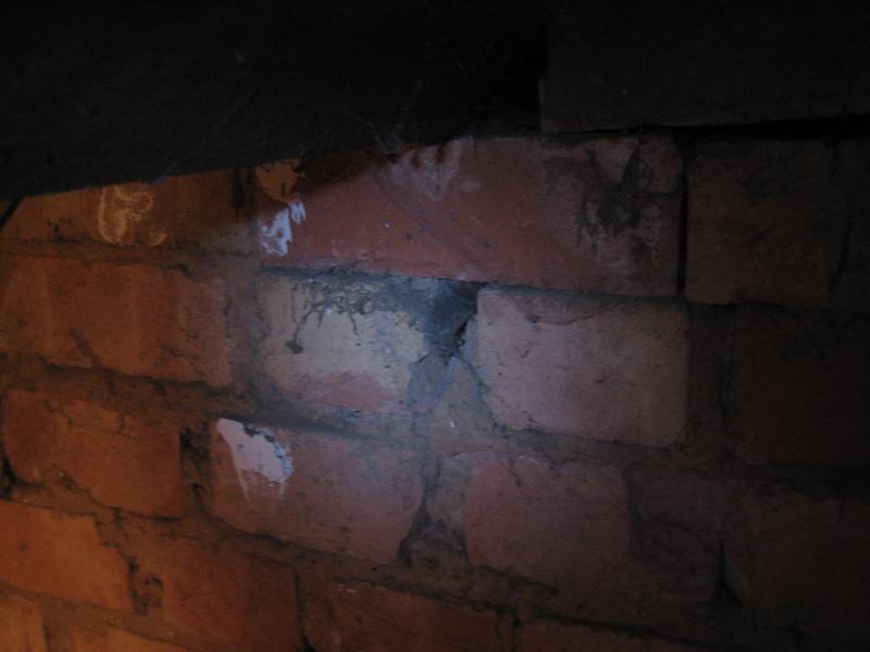

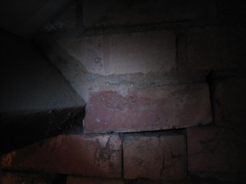

Well I've started removing some of the plasterboard and floorboard, and what I've seen so far is a bit scary. My main concern so far is the state of the walls around the purlins on one side of the house, it looks like they're crumbling away beneath them!! It also looks like it may have been hastily repaired at one point, but I'm no builder, anyone any idea what's happening?
I'm also quite confused about what's going on with these struts, as they don't appear to actually be doing anything...
There's 4 struts along the purlin length, and each one is supported by a small bit of wood which is sat ontop of a couple of ceiling joists. I can't imagine these are contributing to the roofs strength in the slightest, I'm thinking they've been installed by the previous owner as some poorly thought out supports. Any idea what on earth they're for?
Judging by the photo, that's pretty normal to me
