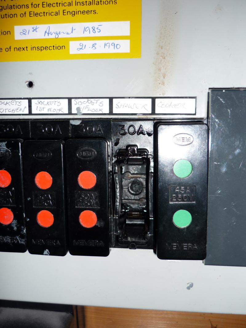

I have a redring electric shower which blows the 30amp fuse everytime its used. Just started to do this over the past few days. Seems to last a bit longer if the shower water temperature is kept a bit lower. Have looked inside and wiring, etc. appears ok. See pictures. Grateful for any advice on what the problem could be.

I was on a job today where similar was happening.

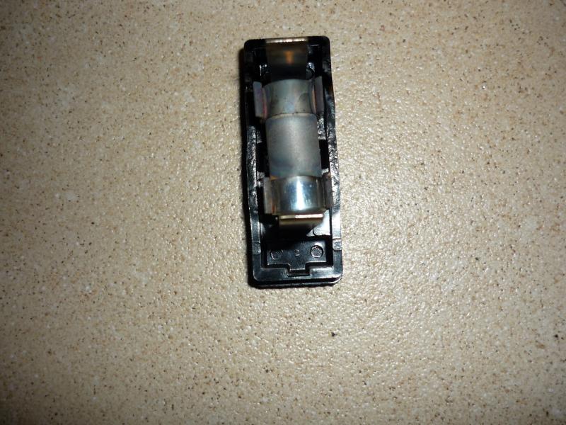

It was a 9.5kW shower on a 30A BS1361 fuse box, and the fuse carrier was burning up. The heat was casing the fuses to blow much quicker than they should according to the fuse graphs.
RF did you replace the casing, or are you planning to run with an alternative solution? Thanks
It needed the shower circuit replacing with a 45A circuit, and a new consumer unit.

Fuses (fuse wire) have a degree of tolerance built in - sometimes up to 1 1/2 times the face value. But if you think about your shower being turned on and off several hundred times (or several thousand times - if you household is like mine) over the past seven years the constant overheating of the fuse, like RF Lighting stated, has possibly caused physical damage to the fuse carrier itself perhaps the ceramic or the brass contacts.
The purpose of the fuse is to protect the cable from damage so in this case it has worked. The current carrying capacity of 6mm2 T&E is around 46 Amps in ideal conditions. This is close to the 41Amps that a 9.5kw shower might pull at full load.
You're never gonna beleive this
Here's mine from today!

That melted plastic stuff should be telling you that it is time to move the shower circuit off that Consumer Unit.
I would have an electrician come out and examine the internal part to see if the damage is just confined to the visible area in the photograph or has it spread.
It could spell the end for the whole of the consumer unit.
In broad terms you will have two options.
Assuming the current consumer unit is 'knackered' then you will need to have it replaced - this will give you the opportunity to put the shower circuit on a proper footing regarding RCD protection and the correct size MCB.
If the current consumer unit can be saved then I would suggest you get an additional shower consumer unit. This will involve splitting the incoming supply. This new unit will give you both RCD protection and the correct size MCB.
Whatever you do - DO NOT put another fuse back in the Consumer unit or swop the shower circuit to another fuse.
