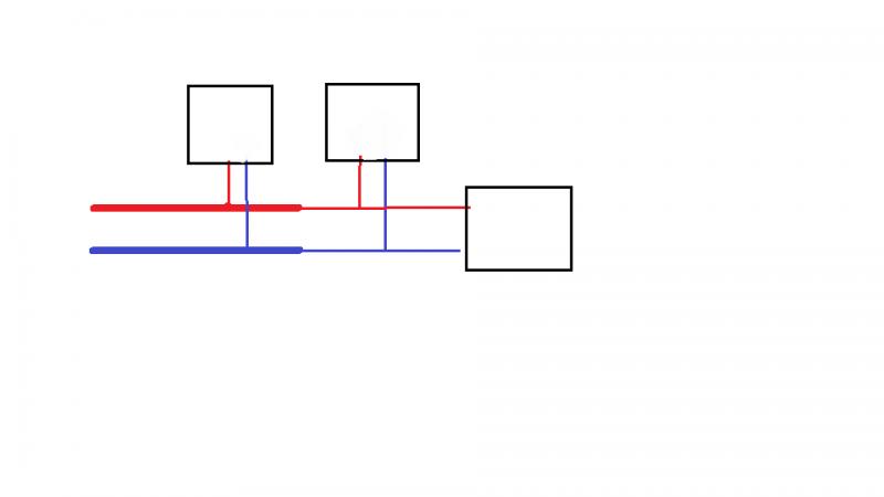

Sorry your missing my point my fault im not explaining it very well. I have 22mm round most of the house the last two rads (not getting very hot) are on 15mm the redcucers are on straight runs of pipe. Would they be better on Ts. Ie at the third to last rad 22mm down to 15mm on the branch and to 15mm on the trunk. Or will this not make any difference.

A system with a mix of 22/15mm should work spot on with a bit of balancing, have you tried that?
Maybe draw a diagram and post it up.

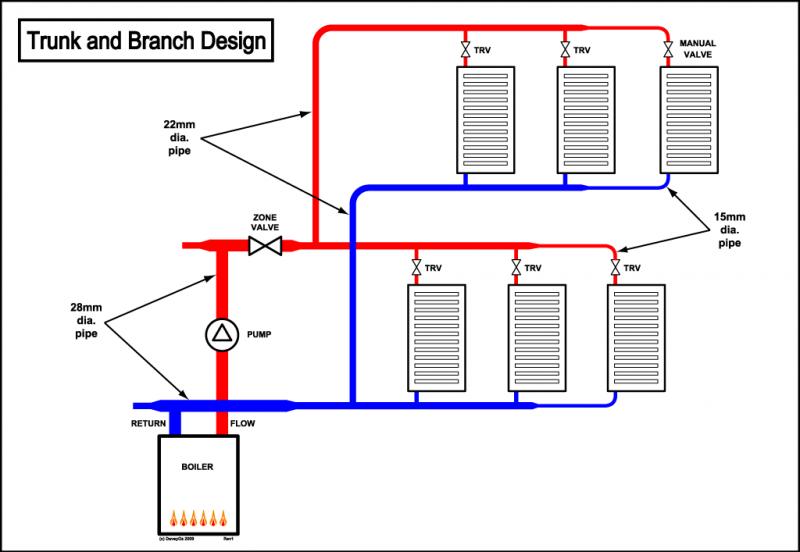

heres what i mean by branch and trunk this is off wikipedia.
my set up is slightly different the last TWO rads are on 15mm :
the whole system is fine apart from these the last two rads.
Ah, trunk is probably American terminology then.
There's nothing wrong with the second picture, the system will just need balancing. Do a search for balancing radiators.
Spot on Andy, i thought they had been balanced but on inspection the valves were fully open. I suppose the flow was far too fast through them. Thanks for your help and all the best.
