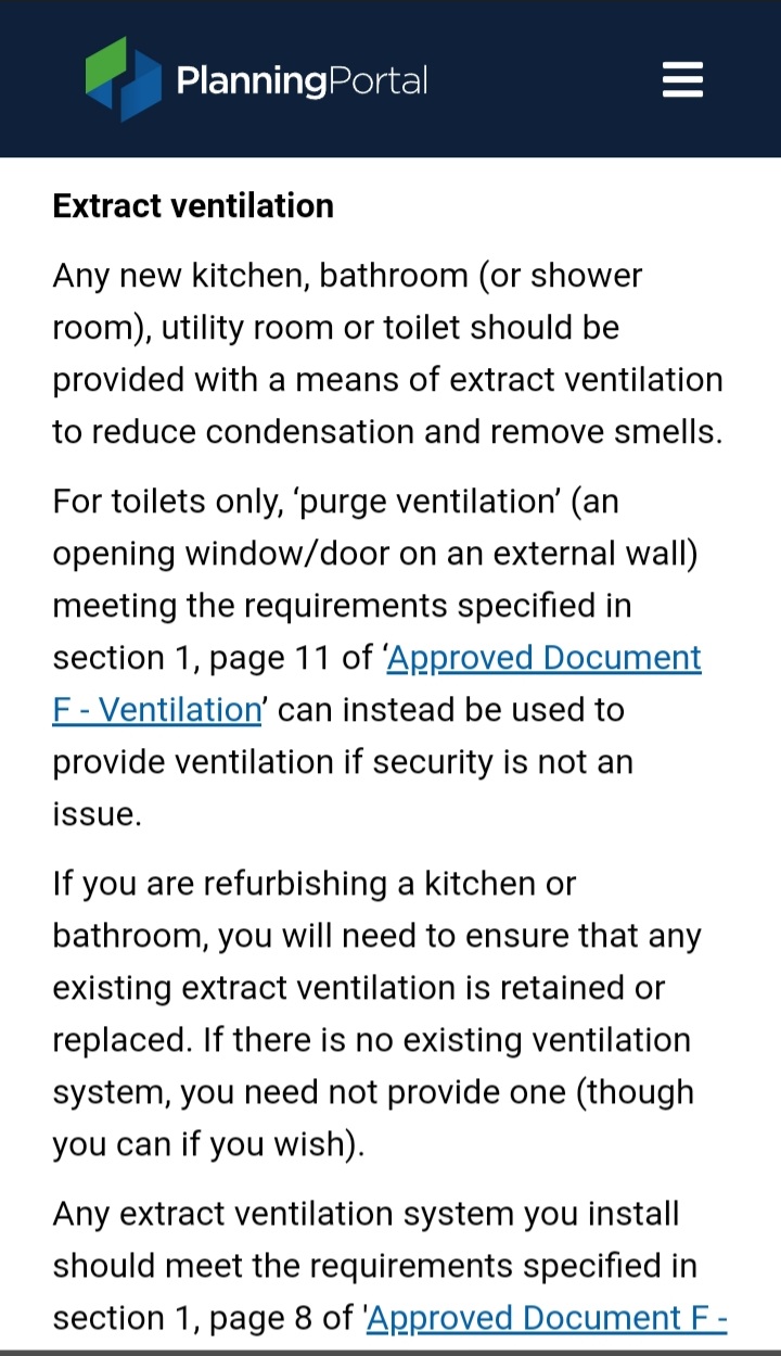

Why bother (with a fan)?
It depends if BC are involved...
ADF is like ADP - merely guidance.
Part F does not say fans are compulsory.
Does everything have to be a fight! :)
Building control should be involved with this project, as it requires a new foul drain connection. They will very likely be interested in other aspects of the work.
Yes, fans are not compulsory under part F, but for the sake of pragmatism and gaining my completion certificate, I would be looking to follow the BC guidance.

ADF is like ADP - merely guidance. Part F does not say fans are compulsory.
All true - but, as we know, just as the guidelines of Approved Documents are not compulsory/mandatory, nor, it seems, is it compulsory/mandatory for BCO's to restrict their 'requirements to what is actually required by the Building Regs (Part F in this case) - and it seems that many of them probably use the Approved Docs as a guide to what they will personally 'require'.
When a BCO 'demands' something which is not actually required by the regs, there is obviously potentially scope for argument, but many probably feel uninclined to get involved in all the hassle (and they may not 'win').
If one wants a fairly quite life, then a degree of pragmatism may be required. If a BCO demands a fan, then he/she may well be satisfied by seeing some sort of fan, with any sort/size of ducting (if any!), even if the fan is removed immediately after the Completion Cert is issued ;)
