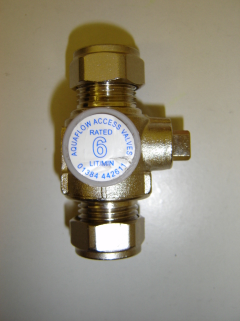

I have a c/c cistern installed but it is very noisy when filling. This is caused because I have had to turn the ball valve to nearly closed to reduce the flow because if it was fully open, the flow would be too great and the cistern would fill too quickly. The overflow would not be able to cope if it was needed.
Is there a restrictor or something that I can install at the ball valve or where the flexible hose meets the cistern inlet that will restrict the flow so that I can fully open the ball valve.

What sort of valve has it got? A standard plastic float operated valve comes with different seatings for high and low pressure. The high pressure one is generally white and the low pressure red. Other valves come with inserts to reduce the flow. You may need to change the valve to get one with the inserts you need.
fit a silent filling valve. I used to use Torbecks or the very similar Armitage Shanks but some people say the Fluidmaster are better. The design has changed recently and the new ones are bigger. Opella (who make Torbecks) have a fantastic after-sales and will send you replacement parts foc if anything wears or becomes noisy. The old model Torbeck was supplied with a spiral flow restrictor for very high pressure supplies but I don't know if that's needed with the new one.

They are prone to dirt or grit in the water so you may need to take them apart and rinse every few years. If there is a service valve to the cistern it is much easier to do that (it sounds like you have as you say you have turned the valve down)
It is easier to change cistern valves if they come in from the side rather than the bottom of the tank. Make sure you buy the right one.
The new flushing valves are also far quieter than the old syphon, especially the Flapper which is a masterpiece of simplicity and gives a powerful and quiet flush. Replacement flappers are available as service parts..

You could fit a flow restrictor.
Or you could, as suggested, fit a Fluidmaster inlet valve. These discharge below the waterline and are very quiet when filling.
