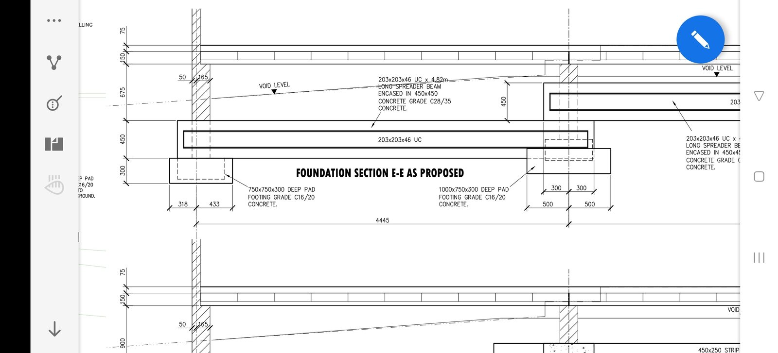

Encasing the beams is not hard but perhaps not cost effective given you're on a cost saving excercise.

A set of four 203x102x23 UB with a 275x10 welded plate would be about £1.5k or 250x250x10 SHS would be about £2.5k. Obviously I don't know what beam would be needed for a 3m span but either of those is a lot cheaper than a ground beam
I'm not sure about that.
I did a 6m x 6m orangery for a client (who conveniently "forgot" to mention the big patio where it was going used to be a huge pond)
From memory the SEs charged a few hundred quid for a rebar schedule, the reinforcing bar cost about £1500 and then it was the cost of the builders to tie it all together and cast the concrete....which is probably no more work than the steel beam option....which will need encasing anyway.
From memory the 8 driven piles cost about £6k
Have you considered a raft?
Case them in concrete with 50mm min cover :D
I'm not sure 50mm is enough, but even so, by the time our thrifty friend has paid for shuttering and concrete (and ancillary costs) he'll be cursing his bro and his big ideas in a very uncivil way.
