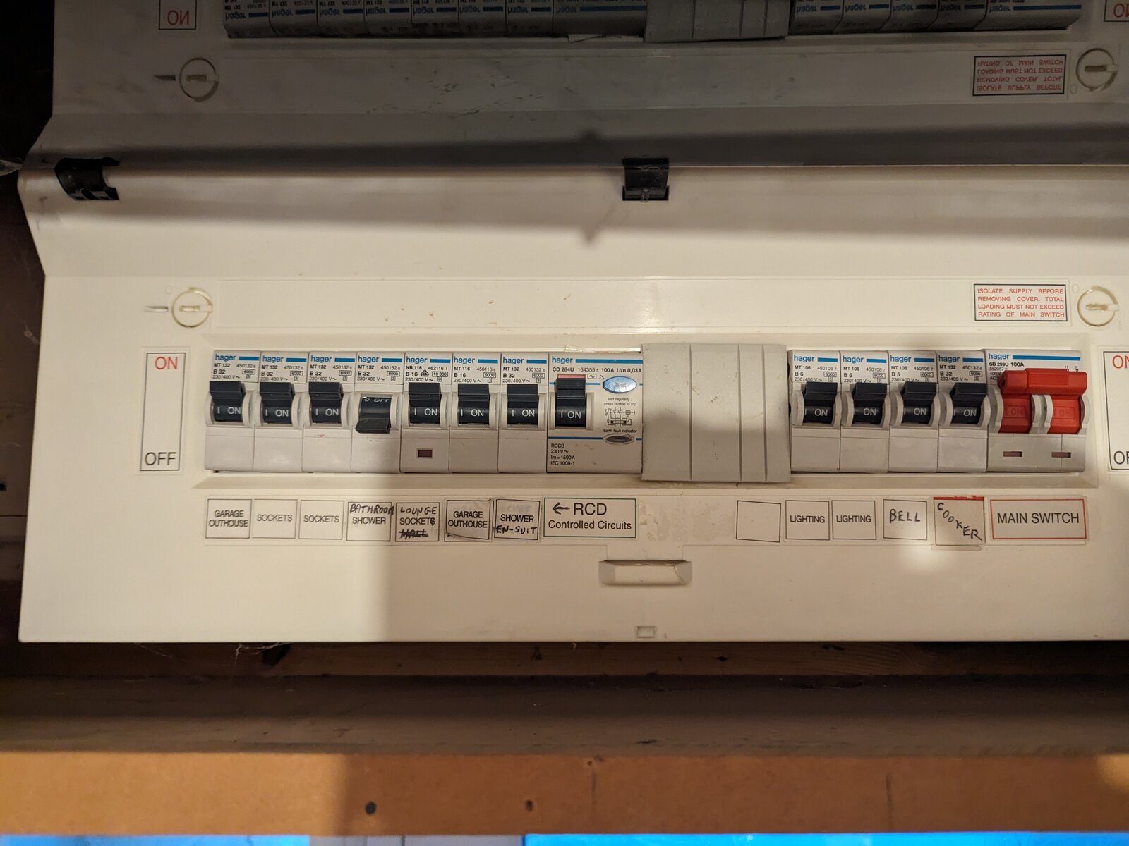

I'm replacing the electric shower in bathroom with mixer shower.
I've already taken out the shower unit, the water feed pipes and the pull-cord in the ceiling that switched it on and off, but now have about 6m of cable in the loft where one end is attached to MCB and the other is free, dangling over some beam up there.
There is currently no power to the cable as I switched off the particular MCB that supplies it beforehand (obvious I know, but some may ask...) but I would like it gone permanently. I can replace the MCB with a blank to save accidents... The main box itself is high up and enclosed, so the chance of someone accidentally turning the switch back on is slim, but I'm still a tad concerned - bare wires give me the heebie-jeebies...
Is it an easy (safe) job to remove the cable from the MCB myself, is it a big enough job to get sparks in, or should I just snip the cable in the loft and stick a blank on the end?
Your opinions and expertise would be much appreciated - thank you

Thanks guys. The main issue with the cable is that the box is above the front door .. it's a bungalow so the roof space is extremely small at that point, and there is no way I'll get to it.
There are plug sockets and switches etc in the loft... Spider-infested place... I'll have a think...
This is the main box, btw...

Imagine a roof, pointy at the top, sloping downwards. Imagine a fat sod who weighs 17½ stone and has a broken leg trying to make his way through gaps, in beams and joists, narrower than his waist towards the (very) thin end of the wedge, which is where the cable comes through ceiling into the box...
The shower and the switch on the opposite wall that supplied it with power were easy enough to disconnect, then jumped up into the loft and pulled the cables up - but those were near the centre of the loft space, in the pointy bit where I can stand up... The junction box is by the front door. Unless I disconnect it there, I won't be able to get to it...

There might have been a misunderstanding. It doesn’t matter if there‘s an existing junction box somewhere. Just fix a new one to a joist where the cable ends and that‘s it.
Make the cable safe but still around for future use.

Perhaps my terminology is wrong... the panel with all the mcb's that controls all the electrics in the house is what is above the front door...
