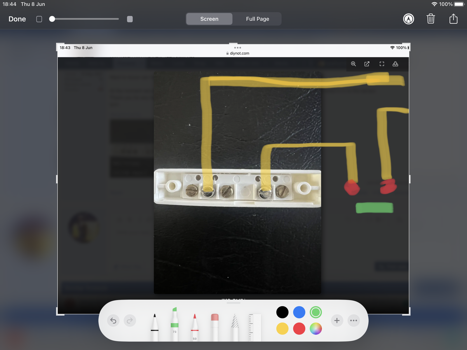

Here goes…. Bike shed with opening roof and door.
Fitted a sensor connected to house alarm, and it decided to wake the street at 3am. ( hubby said it’s too sensitive - creepy crawlies) so purchased two magnetic reed switches.
Don’t really want to run another wire from front path through house to alarm panel… took hours for the one he fitted.

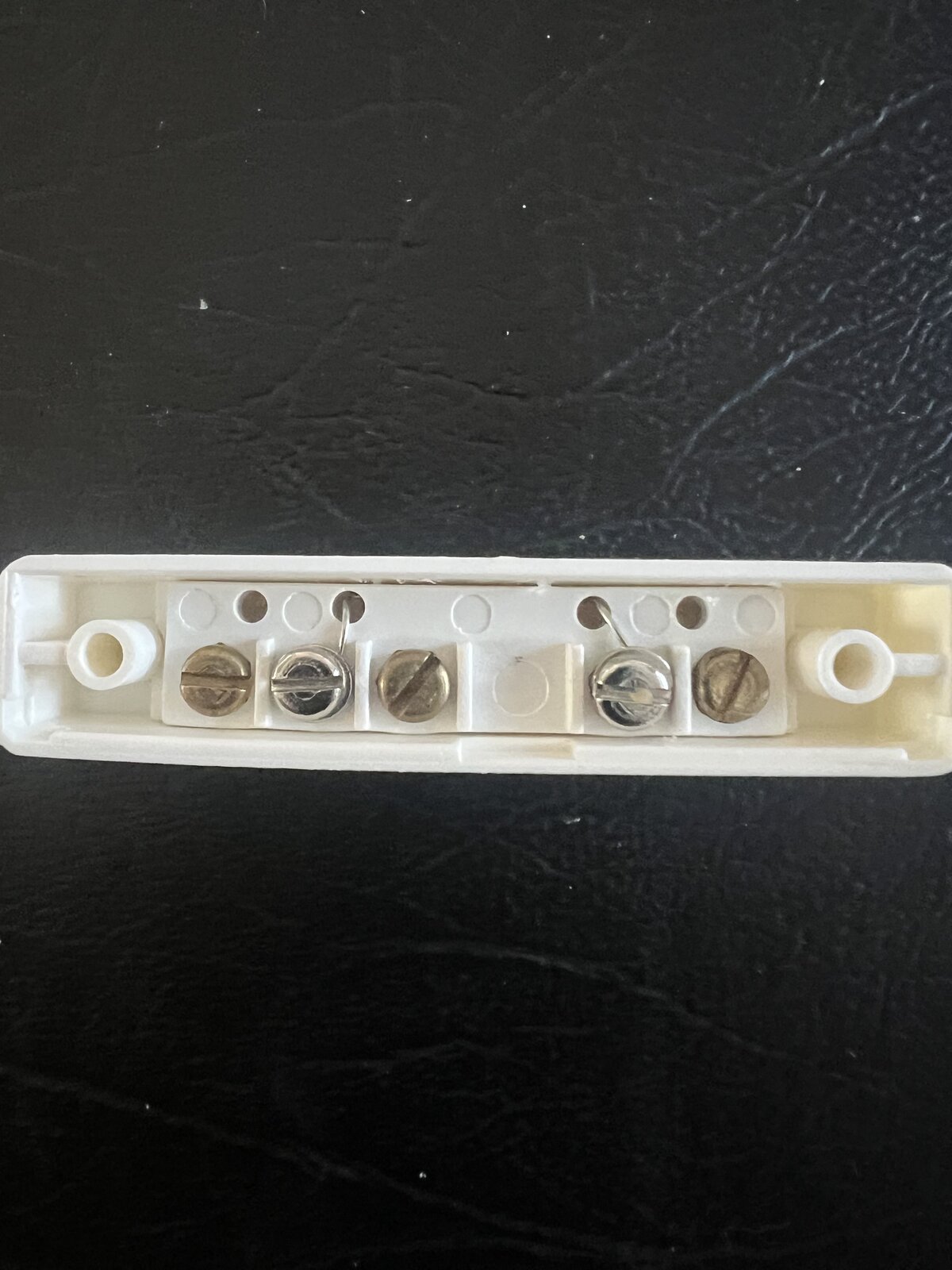

Want to know can he wire them in series -if yes could you draw me a nice picture please
At the moment red and black are pos & neg green and white go to zone 6 at panel. No anti tamper wired in in to the sensor.
Thank you for any help /advice.
lynn
Yes red being the two screws on the other contact …may easier with a junction box …a quality sensor in the shed would have ok …

I think you may have gathered we know nothing about alarms. Do these not need a pos + neg?
Both switches wired in seris, alarm won’t activate with either roof or door.
does hubby need to tell panel it has switches on zone 6 - or should it work thinking it still a sensor connected. ?
Zone should be closed circuit with both doors closed and go open when either door is opened. Probably got a broken reed switch in 1 of them
They both would be shorted if nothing is activating ….step one twist the green and white together at the shed ….set alarm , untwist the green and white …..alarm should activate ….
