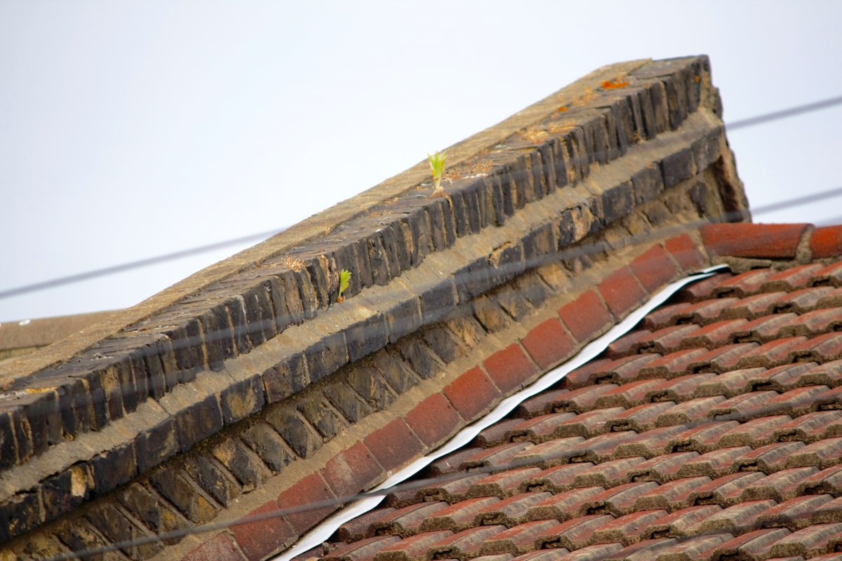

We’re having leaks though the cement fillet flashing between the roof and parapet walls on our victorian end-of-terrace. As such, we want to replace the flashing with lead whilst at the same time patching up the top of the parapet walls themselves (brick-on-edge coping) as many of the bricks are pretty knackered along with gaps in the pointing and plants growing!
We’re getting 3 quotes but they’re all suggesting different solutions and I’m struggling to work out what is worth spending the money on.

Got a photo or two of what's there now? And not just a close up but so that we can see things in context.
A few pictures of the front:
The odds are that water is entering below the flashing - the flashing is incorrectly installed, its too shy/narrow, and has not been dressed across the marley major conc tiles.
The fillet and cover tile and lead will have to be lifted along the parapets and chimney stack abutments.
New, wider lengths of lead will have to be chased into the brickwork and dressed over the tiles see calderlead.co.uk abutment flashings (or similar) - only you cannot use stepped flashing, the chase in the parapet has to be on the rake, a long slanted slot.
The fillet on the corbelling must be replaced and possibly selected perished bricks on the top edge of the parapet.
Rendering over the top and down to the corbelling might work - it will work in with your neighbour's parapet render.
Coping stones will also work but they must be a party wall decision.
FWIW: you have four air ventilation terminals on the stack - presume you have no active fires or heaters of any kind?
Are the four flues vented below and have the flues been swept and smoke tested?
Pic 1. shows water staining at and around the fascia and soffit - are water stains present in the bedroom near the bay?

Ref the step flashing - the brickwork below the corbelling has been laid on the slant. Anyway, thats how it appears on my screen. The chase is cut with an angle grinder.
The staining looks more recent esp. the yellow stained render - moisture could be finding its way down from the faulty flashing.
