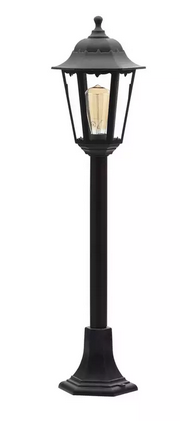

New outside light, at moment using a compact fluorescent lamp, but will be looking at a smart LED lamp, however in the main they shine up, and lamp is of this 1684084818327.pnggeneral design, although not the one shown, and the lid is over sprayed with mat black, so the light is not directed up the drive as required, so considering some reflector if only tin foil. But near every lamp I look at seems to be missing any reflector, I have one battery powered lantern with a special parabolic type reflector in the top, you can see some thing here 1684085691854.pngwhere some cone shaped bit in the top tries to redirect the light, to what effect is hard to say, so simple is a piece of hexagonal cardboard covered in tin foil placed in the top, but how much will the reflector help?

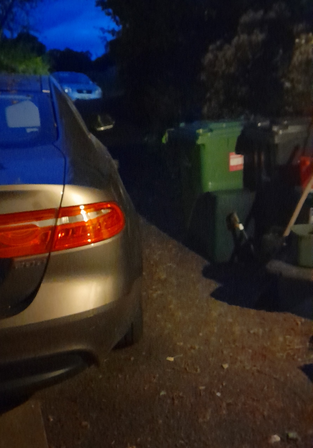

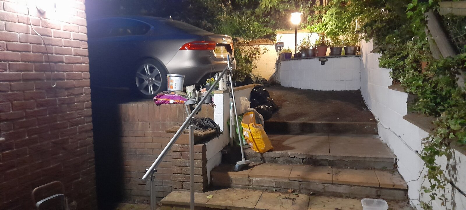

The existing CFL shines axially, however want to change to smart bulb, 20230514_215036.jpg the two lamps together should then light the path when we arrive home after dark. The right hand lamp is the one in question. Looking up the drive 1684137229960.png the light starts to fade out before the street lights take over, think the disposable roasting dishes may be the way to go, a little stiffer than just tin foil.

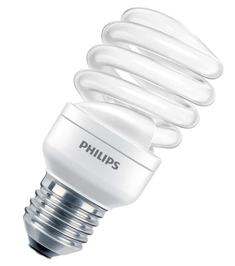

If not going smart then the CFL will do the job well, the existing bulb 1684306389844.png of the design shown does radiate the light well, the problem is moving to a smart bulb, at the moment using a smart adaptor, but can't dim the light, or change colour with that, and also Nest Mini does not see it as a light, so the command turn on outside lights will not include it, this is the problem with the integral LED outside light, google home does not see it as a light, with all others as long as put in the app as outside, the single command works, in the main on getting home it is "hey google turn off outside lights" but need to manually turn off the socket adaptors. I have same problem with the relay in landing lamp, but by calling it landing light hey google turn on landing light works, but hey google turn off all lights does not.

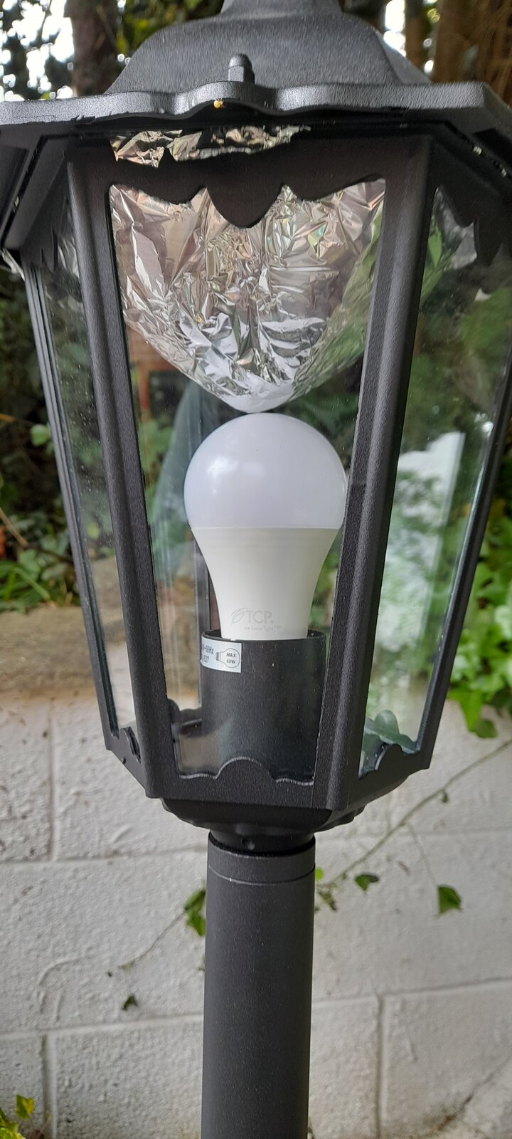

20230518_174342.jpg So I have used simple tin foil, seems to be working OK. 20230518_223307.jpg so will make something which looks a little better, as concept now proved, not sure about colour changing option 20230518_223226.jpg but maybe fun at Christmas. At a £1 more for colour changing, why not? But can't see the option being used much.
