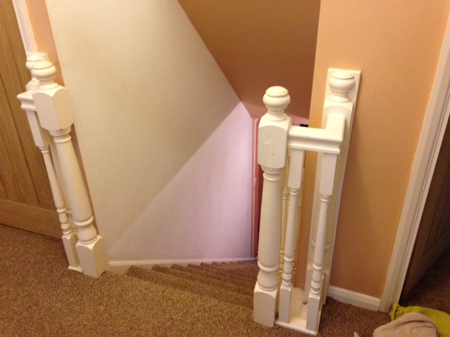

At the top of our staircase there's currently a small section of balustrade. How would the pro's go about tackling this when fitting an oak & glass kit such as the one we're looking at?

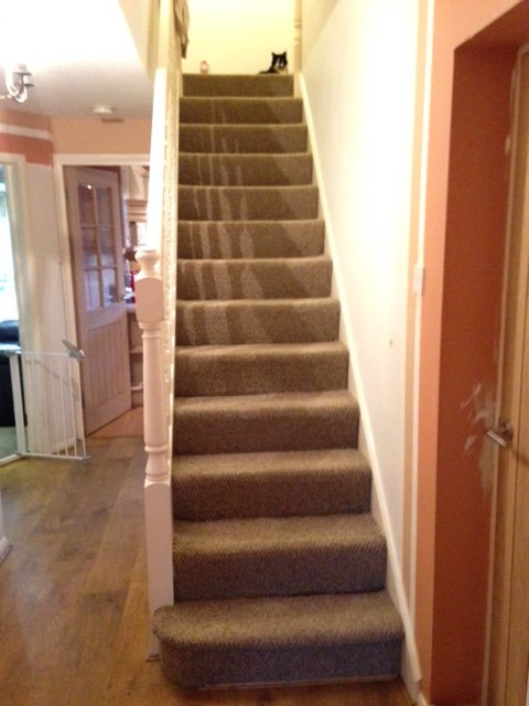

Pics below to give you a better idea of what i'm talking about.

I'd love to remove all the woodwork at the top but not sure how to redesign it?
I was thinking of completely removing the newel on the left. Obviously i'd need to keep (ie: replace) the one on the right but there'd be a 10-20cm gap between the wall and newel post. It's a bit of an odd gap, not sure what to do with it.

The one on the left has no purpose but to balance the picture
The right hand one does little.
If there was a gap then if it was bigger than the max allowable distance between spindles, a bit of tempered or laminated glass could be fixed to the wall at 90° to the stairs to butt up against the infill panel
ok so if cut the left hand post off at floor level this wouldnt weaken the staircase?

Assuming you're talking about the posts upstairs, then no. You'd drill 100mm down the post left on the floor, and glue (gorliia glue) in a 1" dowel, then drill the new post to drop over the dowel, and then glue that in place.

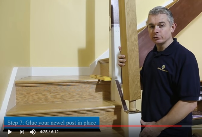

But wouldnt that leave part of the original white post visible? I assume you mean like the image below (nicked from youtube).
I was hoping i could remove the whole bottom post as well as the top ones, then fit a new full oak post using some kind of zip bolt or other fastener? The ground floor is concrete so i assume the current post is secured by an anchored fastener and also screwed into the side of the stair case.
I have removed the entire post downstairs and pinned it to the stringer
I basically had to make a slot to slide it downwards
Upstairs, I can't quite remover what I did but managed to remove the post and secured it to the floor joists

Sorry Preecy, I assumed you'd be cutting the post off at ground level, so didn't bother so say anything else. At the top. the post will be secured to the string, and very likely a joist under the floorboards. On the ground floor post, it'll also be mortice and tennond into the string. If you've done it once, then you should be able to handle this, but it might be worth getting the pros in to make sure you get the look you want. As you're just changing the post and the banister rails, I assume you're keeping the exisitng stairs, and the carpet.
The youtube video didn't play, but the picture shows the idea I was trying to get across.
Thanks Doggit. I was hoping to completely replace the old newel posts (bottom and top right, going from photos above) with new full oak ones. The plan was to do away with the top left newel which i have just done so. We didnt feel this served any purpose and as Tigercurbridge pointed out, it was there for aesthetics only. You were correct, the post was secured to the string and came off fairly easily without any damage to the stringer. The newel had been cut to the shape of the riser/tread and then pinned to the stringer with a couple of dowels. It didnt appear to be secured to any joist, if it did then it came off very easily. I guess the other top newel is connected in the same way. My concern is mainly with the bottom newel. It's not some much the removal process, my doubts are with my carpentry skills. I'm not sure i'd be able to cut and securing fit the new oak newel without leaving unsightly cuts, gaps, drill holes, etc. Also, i'm still not 100% sure if the bottom post serves any structural purpose to the staircase?
