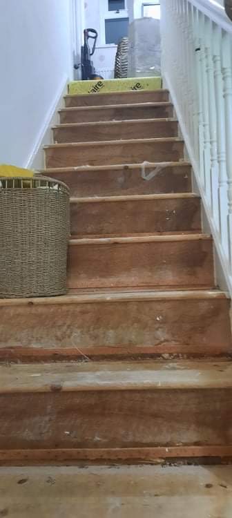

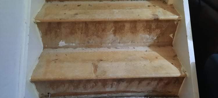

We have a very stubborn Sausage dog who don’t like getting her feet wet when it rains and would sooner pee on our stairs carpet, after a few new carpets I have officially given up with that idea and I’m exploring our options and we are looking at leaving it as wood.
Pictures show as it is now with the carpet and a few grippers removed, the tread is pine I think and the riser looks to be ply (not sure).
questions
I am ok at DIY
Is it possible to sand the treads and risers down so they can be finished with a clear or light varnish/finish? What would you recommend for stairs please? Would this look good or will the risers need a covering?
would also consider stripping the wood at the sides (currently White gloss) is there a good product for this? Is it worth it?
just look8ng for a fresh clean finish that don’t need too much ongoing maintenance please.

It's a little difficult to tell from the photos, but I get the impression that the stairs have been finished with something in the past (?) or maybe had something glued to them at some point in time. Anything which seeps into the grain of the wood can affect its' ability to take stain as well as [
possibly leaving obvious marks if clear lacquer finioshed. Before foing the whole hog, I'd suggest sanding one tread and one riser only, then coating them with a good quality floor lacquer (sometimes called floor varnish) from a reputable make such as Morrells, Osmo or Bona. Avoid oil finishes as they may come out patchy on a refinished surface, and in any case they aren't durable. Also, avoid waxes or any other finish which increases the risk of slips. Doing a single step should allow you to gauge the effect of clear lacquering before committing yourself

Hi, thanks for all the replies and advice so far. We live in a detached so the noise isn’t a problem, I have cleaned the bottom 2 steps with WD40 and got all the residue off, just need to sand them now.
what is the best sander to buy please that will get into the corners as that’s where the gloss has overran in the past, (not by me I hate the stuff ).
TIA
TIA
A mouse sander, they have a plate similar to a small clothes iron and you can get the pointy end right in.
