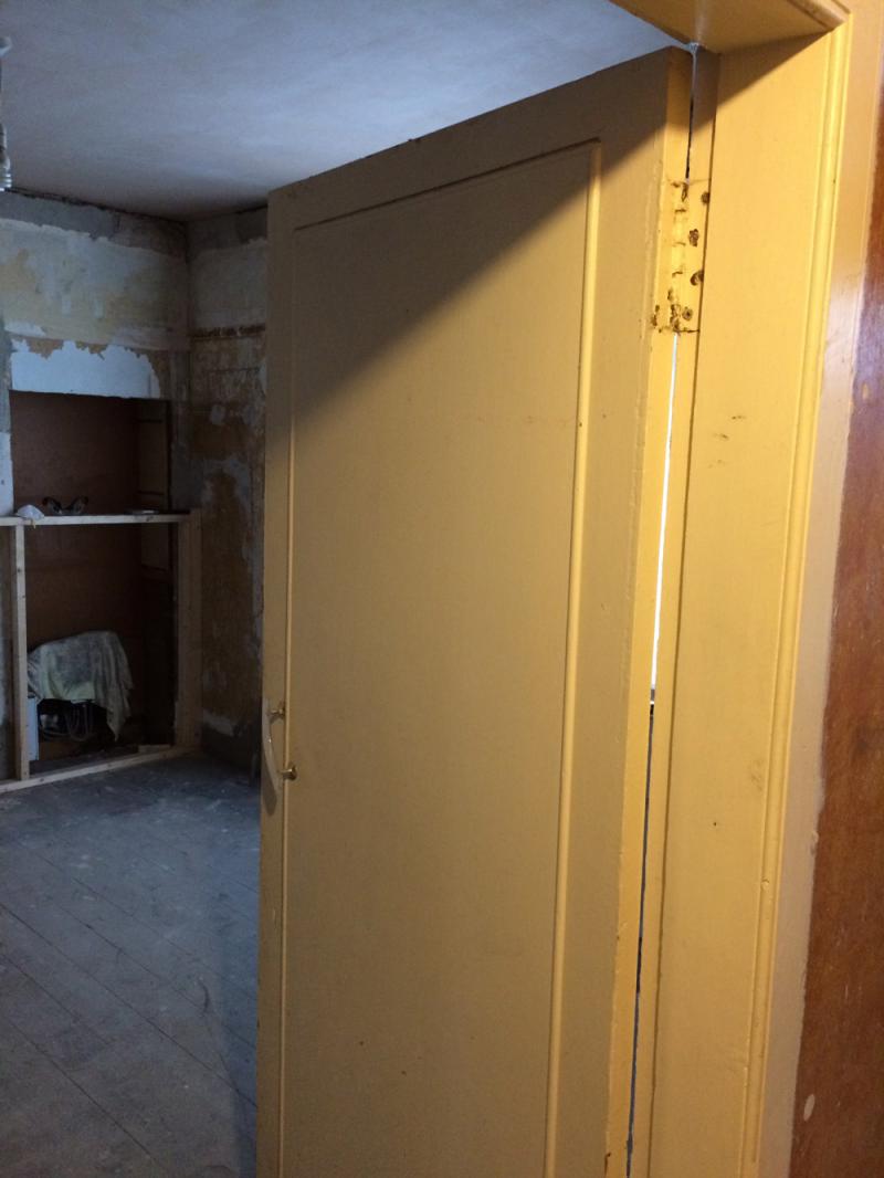

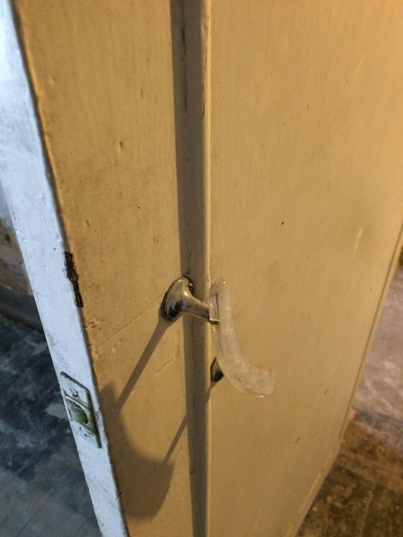

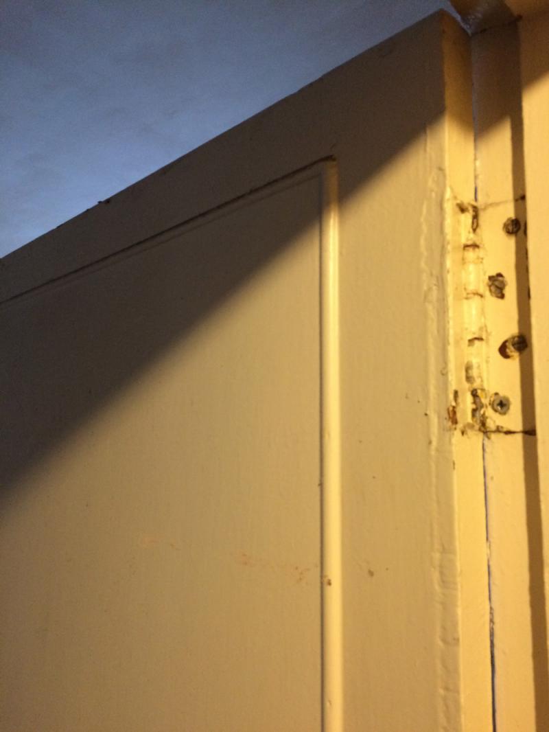

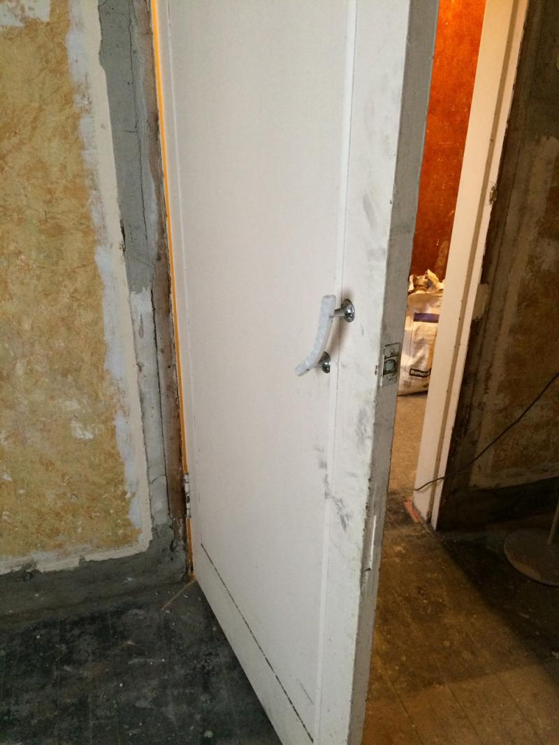

My house is approx 100 years old, and I'm "Very" Slowly but surely trying to rennovate it, but having to get on a bit quicker and cheaper now due to family circumstances.
The internal doors (or at least the origional ones) are approx 34" (33 3/4inch) by 81 1/2" tall
Which seems to be a hard to get size nowadsays, I dont want the upheaval of ripping out door frames and replacing, and was wandering how folk get on refurbing them.
They seem to be 4 or 6 panel doors which someone has nailed some edging and hardboard to and painted over.
Is it worth peeling these off and using some sort of filler in the screw holes left by handles ect and just trying to reuse or do they tend to look rubbish after? Dont mind a rustic look in the house, but dont want them too look really worn when everything else is getting replaced

It depends on what you find underneath. I've come across doors which would have had bolection mouldings originally (they sit proud of the surfaces) and where the "moderniser" had seemingly hacked the mouldings flat with a fire axe - or so it seemed - before putting the hardboard over. The only way to find out is to strip one and see how bad it is first
If they are half decent you might find that by stripping them (not a dip strip though - that will potentially destroy them) you can get doors which will take a waxing and where the nail holes can be filled with coloured wax (e.g. Liberon) to disguise them
I'd also get rid of the naff handles and spring latches. the house possibly originally had something like rim latches or rim locks fitted (check the door casings for evidence if these) which with appropriate handles are a nice touch
