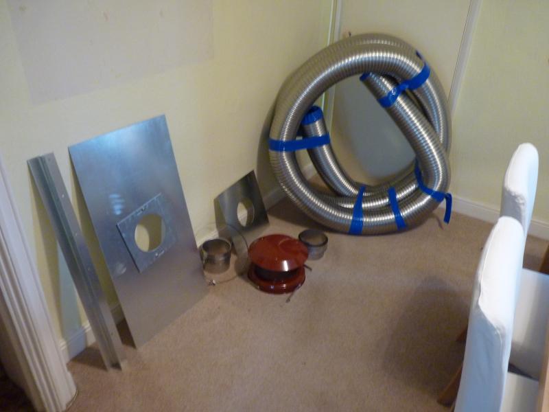

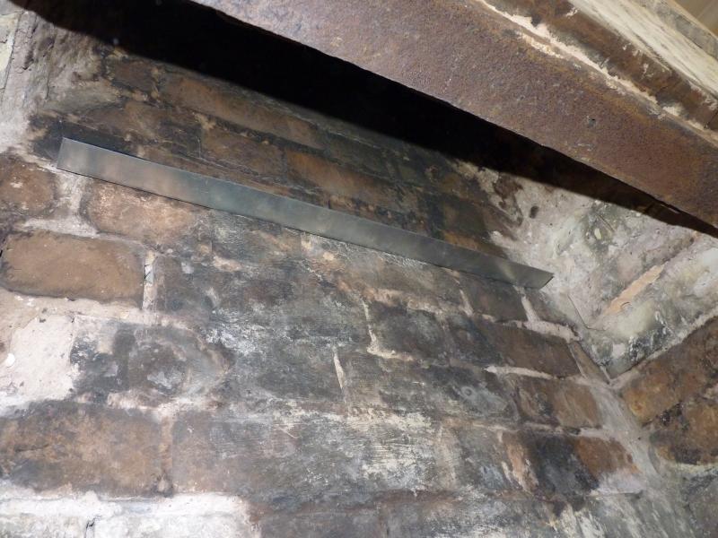

I was wondering about this before it arrived, but deep down inside I was hoping that when it arrived it would come with some magical and obvious solution. However, it didn't:

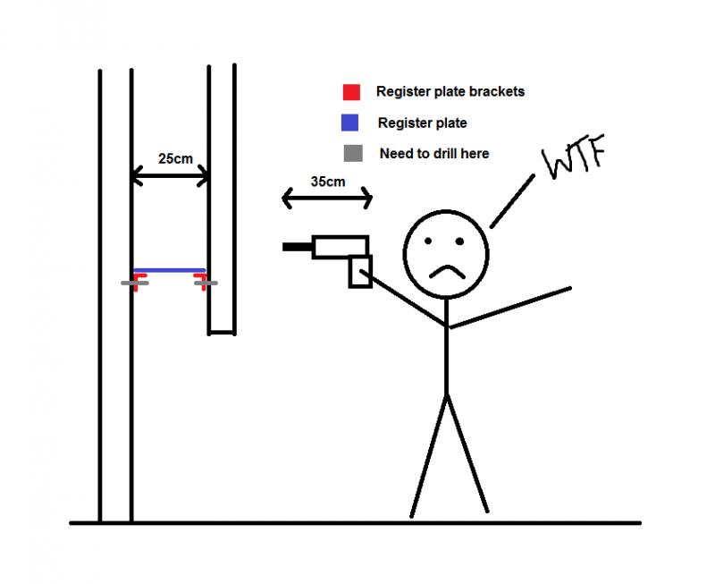

How do people fix register plates in place in a (pretty standard looking) ~25cm deep chimney, if even a small drill won't fit in there?
I doubt this is going to help me; I'd need hammer action for masonry:

How do people usually fit these?
Use one of those 90 degree attachments and blue Bosch multi drill bit - you won't need hammer.

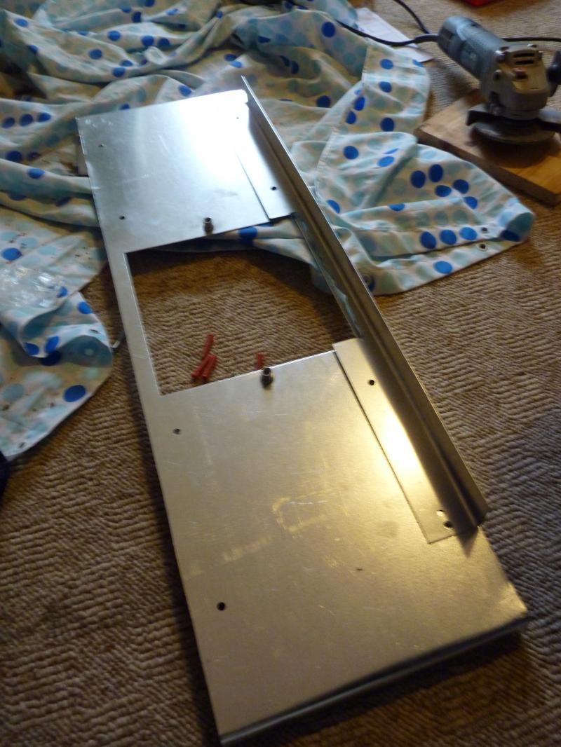

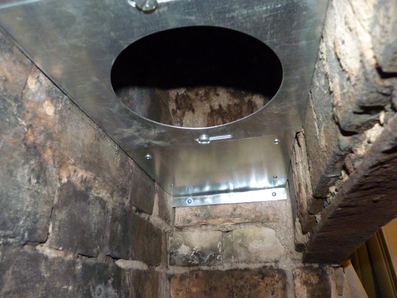

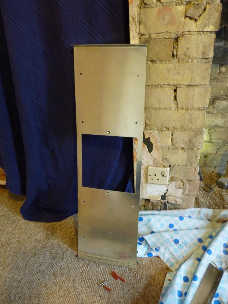

Yup. Pretty standard stuff. Register plate for a woodburning stove. The plate is a ~1-2mm plate. I think I'm going to give up on the brackets, cut the register plate into a sort-of cross, then fold the arms of the cross down and fasten those to the sides of the chimney, which, as the chimney is wide but shallow, I can drill into.

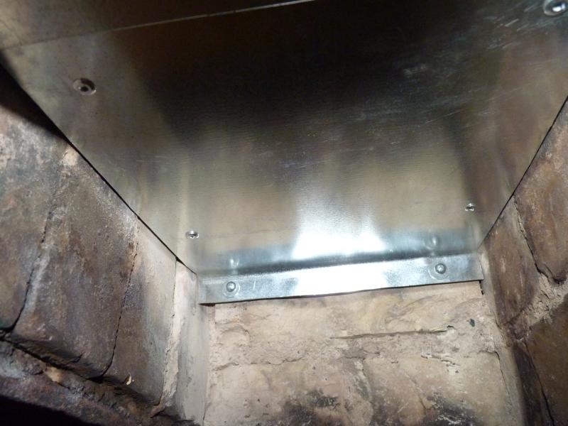

You dont need to fix the angle iron up so high, plus turn it the other way round so as the one flange is pointing down instead of up.

Yeah, good plan. That's what I did in the end. I attached the rear of the plate and the sides. The front is not attached to the chimney breast, but I've rivited a piece of angle iron across the front, and it's surprisingly rigid. It's not going anywhere :D
